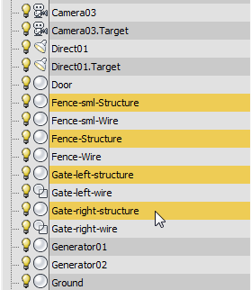

- On the Scene Explorer panel, click to highlight the structure objects for all the fences: Fence-sml-Structure, Fence-Structure, Gate-left-structure, and Gate-right-structure.
- On the Slate Material Editor, make sure the FenceSupport material node is active, then on the toolbar, click
(Assign Material To Selection).

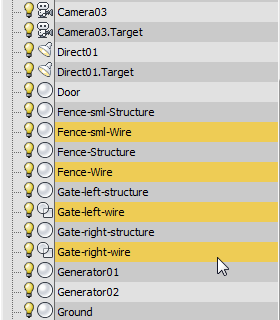

- On the Scene Explorer panel, click to highlight the wire objects for all the fences: Fence-sml-Wire, Fence-Wire, Gate-left-wire, and Gate-right-wire.
- On the Slate Material Editor, make sure the FenceChainLink material node is active, then on the toolbar, click
(Assign Material To Selection) and then turn on

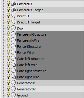

- With all four objects still selected, go to the
Modify panel and apply a UVW Map modifier.

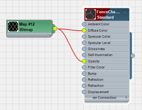

- In the active View, drag a second wire from the Bitmap node with the chain link pattern. This time, wire it to the FenceChainLink material’s Opacity component.
Bitmap controlling both color and opacity
