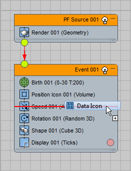

To create a new operator, you can use any of the Data operators: Data Icon, Data Operator, Data Test, or Data Icon Test.
The Data Icon 001 rollout appears in Particle View.
This opens Data View, the user interface for Data operators. Data View works very much like Particle View.

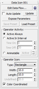

Next, you'll make your operator more complex by linking the speed vector to the orientation of the operator icon. This is the small square at the world origin that was created when you added the Data Icon operator.
Operator Icon group, change the Type from Rectangle to Arrow.
The icon changes to an arrow, which makes it easy to see its orientation.

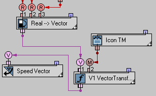

You can use the Icon suboperator to request the transformation matrix of the icon.
Click the Icon Pivot suboperator and then, from the Icon Property drop-down list, choose Icon TM. TM stands for transformation matrix.
You'll use the Function suboperator to multiply the speed vector by the icon matrix.
Type to Matrix. Also set Function to Vector Transform.
Click the wire between the Convert suboperator (Real --> Vector) and the Output Standard suboperator (Speed Vector) to highlight it and then press Delete to remove it.
Wire the output of the Icon suboperator to the M2 input of the Function suboperator. Note that you're wiring between the same-color connectors.

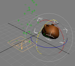

Now the icon orientation controls the direction of the particles.
As you rotate the icon, the direction of the particle stream changes accordingly.
It's just as easy to use a reference object's orientation to set the particle direction.
The teapot's name appears on the button and on the suboperator node.
This lets you specify which object property to retrieve.
Now, when you rotate the teapot about the X and Y axes, it has the same effect on the particle stream as did rotating the icon.

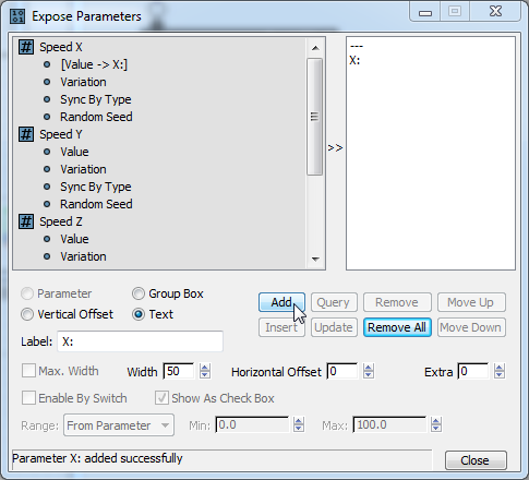

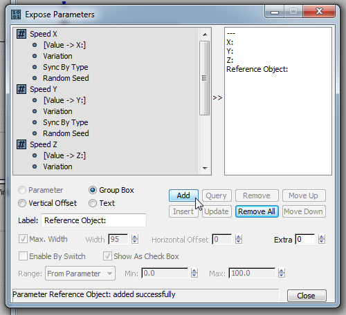

Once you've created a Data operator, you can save it as a regular Particle Flow operator. First, you expose the most important parameters. In this case, they're the vector components; that is, the Scalar suboperator Value settings, and the button of the Select Object suboperator.
This opens the Expose Parameters dialog, which lets you collect and identify the parameters to be exposed. Basically, you use it to create your operator UI.
The entry in the left-hand list changes to [Value -> X:)], and the new label appears in the right-hand list.
More important, the added parameter appears on a new Parameters rollout in Particle View. This shows the exposed parameters, and is available to anyone who uses your operator.
Do the same for Speed Y
Value and Speed Z
Value, labeling them Y: and Z:, respectively.
Object, labeling it Reference Object:. Set Width to its maximum of 95 so there's enough room for the button and label on the rollout. Then choose Group Box. Finally, click Add.
All four parameters now appear on the Parameters rollout.

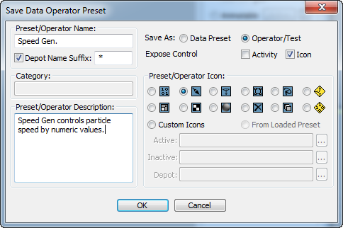

The next step is to save the Data operator as a preset.
This opens the Save Data Operator Preset dialog.
In the Preset/Operator Name field, enter a name, such as Speed Gen.
To the right of this field, set Save As to Operator/Test.
In the Preset/Operator Description field, enter a description, such as this one: Speed Gen controls particle speed by numeric values..
A message informs you that the preset has been saved.
Now the Depot contains your new operator. The name of the operator in the Depot is followed by an asterisk (*), the default suffix, which denotes it as a custom operator.
The teapot orientation controls the particle stream direction.
