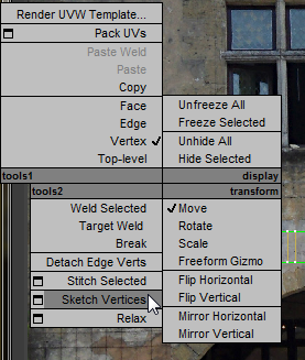

  7. On the Edit UVWs dialog first lower toolbar, the Sub-Object Selection toolbar, click (Vertex) to make the Vertex sub-object level active.

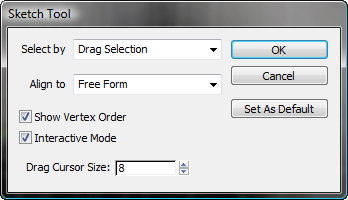

  8. On the Edit UVWs dialog menu bar, choose Tools Sketch Vertices.
    3ds Max opens a Sketch Tool dialog.
    The Sketch Tool options you want to use are Align To = Free Form, and Interactive Mode turned on.
  9. Make sure the Sketch Tool settings are correct, and then click OK.
  10. Right-click the Edit UVWs window, and choose Sketch Vertices from the quad menu.
    When you use the Sketch Tool with Free Form drawing, you work in a two-step manner: First, drag to select the vertices you want to reposition; Second, draw a freehand stroke to show Edit UVWs where to place the selected vertices.
