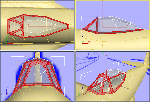

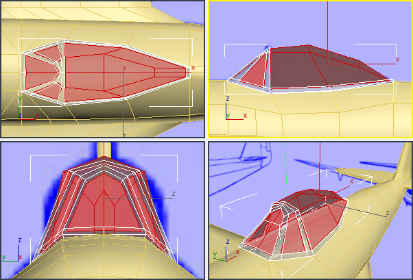

Use smoothing groups to distinguish the metal parts from the glass parts:
(Polygon) sub-object level.
Properties panel
drop-down portion, click 3ds Max opens the Smoothing Groups dialog.

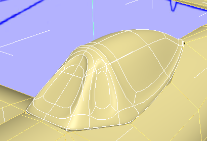

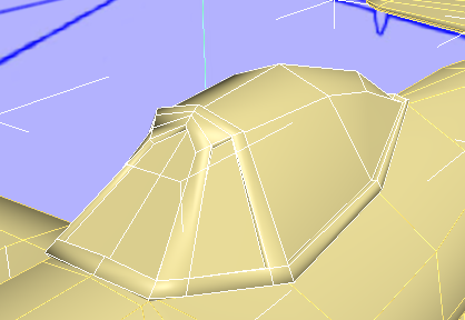

Use NURMS smoothing to preview the canopy:
Edit panel, turn on
Use NURMS panel, increase the value of Iterations to 2.
This is far too much smoothing. As with the fuselage, you now need to take smoothing groups into account.

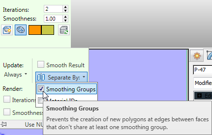

Use NURMS panel
drop-down portion
Separate By drop-down list, turn on Smoothing Groups.

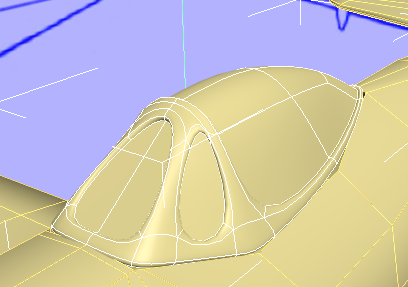

Now the metal and glass portions of the canopy appear more distinct.
With smoothing groups taken into account, there are well-defined edges between the glass and the metal parts of the canopy. On the other hand, the shape of the windshields is far too rounded. You will fix that in the next procedure.
