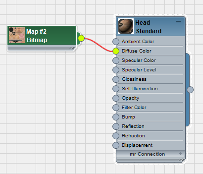

- Wire the new Bitmap node to the Diffuse Color component of the Head material.
- Double-click the Bitmap node to display its parameters.

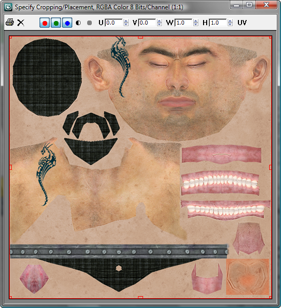

- On the Bitmap Parameters rollout, click View Image to display the bitmap in a larger format.
This image file is a previously created diffuse bitmap of the warrior’s face, based on the unwrapped model.

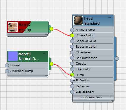

- Drag a Normal Bump map from the Browser into the active View.
- Wire the Normal Bump map node to the Bump component of the Head material node.

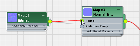

- Wire the new Bitmap node to the Normal component of the Normal Bump map.

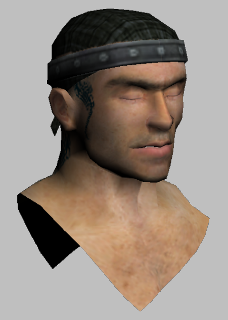

Now the normal bump map will be visible in renderings. To make the normal bump map visible in viewports, you need to go through a few more steps.
Use hardware shading to display the normal bump map:
- Double-click the Head material node to see its parameters.
- On the Slate Material Editor toolbar, open the Show Map In Viewport flyout, and choose Show Realistic Material In Viewport.
Note: If you are using the Legacy Direct3D driver, the tooltip for this option reads "Show Hardware Material In Viewport.".

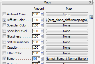

- On the Parameter Editor panel, open the Maps rollout, and increase the Bump amount to 90.
- Minimize the Slate Material Editor.

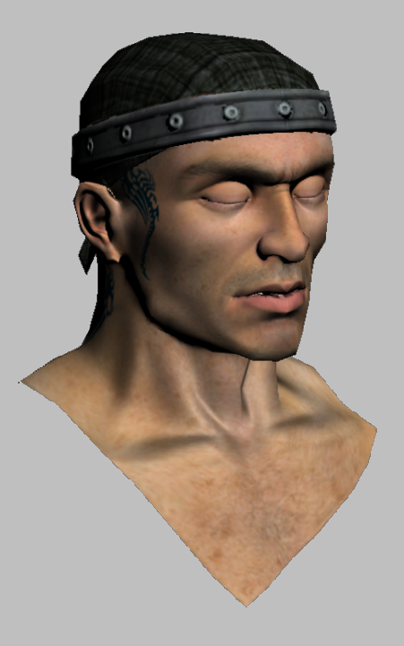

- The model suddenly takes on a new level of detail. The low-resolution model is now picking up the normal information from the high-resolution mesh object.
If you like, try adding an Omni light to the scene and moving the light object across the face: first with the diffuse map selected, then with the normal bump map selected. See how much of a difference a normal bump map can make.
Tip: If you don't see the 3D lighting effect, choose Shading Viewport Label Menu
Lighting And Shadows
Illuminate With Scene Lights. (For Nitrous viewports, this option is available only when the shading style is Realistic.)
Compared to the head that doesn’t use the normal bump map, the difference is dramatic.
