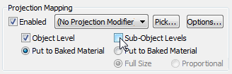

Projection Mapping group, turn on Enabled. Since the plane object you will bake the texture to consists of only a single flat surface, turn off Sub-Object Levels.
If you wanted to bake textures of objects onto multiple surfaces (for example, onto each face of a box), you would keep Sub-Object Levels turned on.

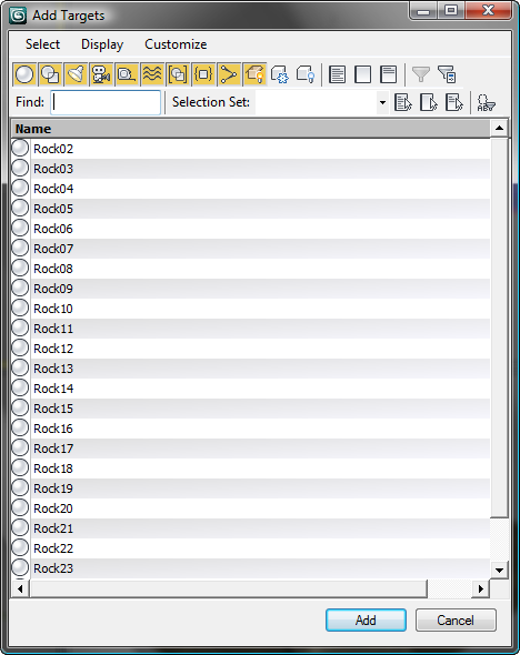

Here, you choose which objects you want to bake onto the plane object.
The drop-down list in the Projection Mapping group changes from (No Projection Modifier) to Projection, indicating that a new Projection modifier, containing the items you just selected for projection, has been placed on the stack for the plane object.

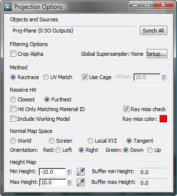

The height map defines the stone and mortar topography of the source object. To generate the map, you must determine both the farthest and closest points between the source and plane object.
In the next two steps, be sure that you are directly above the plane. Height selection will work only if you are above the target object.

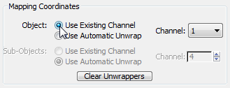

Mapping Coordinates group, choose Use Existing Channel, if it is not already chosen.
The Use Existing Channel option indicates that you want to use the texture-mapping coordinates you created from the UVW Modifier at the beginning of this lesson, rather than letting 3ds Max create new texture-mapping coordinates on the fly.

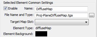

A new Diffuse entry appears in the Output rollout
Selected Element Common Settings group. The file name of the diffuse map to be created displays in the File Name and Type field.

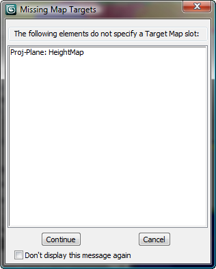

3ds Max displays a warning.
Click Continue to dismiss the Missing Map Targets message box. We deliberately left the height map unassigned, because in the next lesson, you will assign it separately.

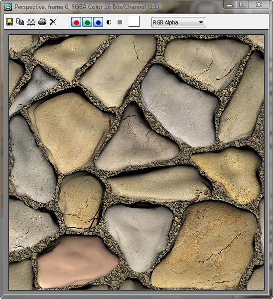

The rendering shows only the information from the diffuse map. The normal bump and height maps have also been baked into the texture of the plane, but they are not visible. In the next lesson, you will use the Material Editor to display the complete projected texture in the viewports.
