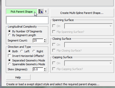

Create the bridge:

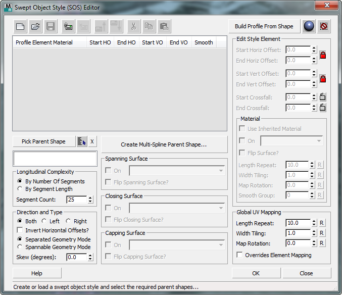

Swept Object Style Editor. 3ds Max opens the Swept Object Style (SOS) Editor dialog.

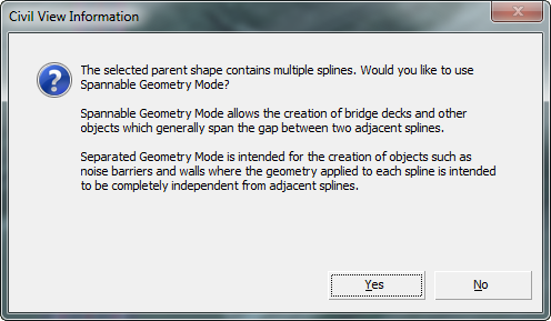

The shape you have picked consists of two splines, one on each side of the roadway where the bridge will be.
3ds Max displays a dialog that asks which mode you want to use for the swept object.
This dialog appears because the shape object contains more than one spline. In such a case, the Swept Object Style Editor can interpret the purpose of each spline in one of two ways. To generate objects such as bridge decks and tunnel linings, the Spannable Geometry Mode is desirable: This mode assumes that each spline represents either side of the road, and spanning and closing surfaces can generate "link" surfaces that span the gap between the splines. The alternative, Separated Geometry Mode, is more appropriate for creating noise barriers and retaining walls: For these kinds of features, the geometry of the swept object is applied individually to each spline in the shape.
3ds Max begins to construct the bridge.

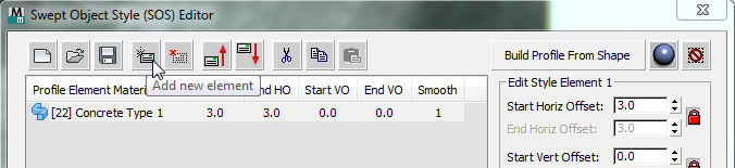

To construct the bridge, you add new elements. As you add and refine elements, you are also creating a specific new swept object style (SOS), which you can save for use in future projects.
(Add new element). After you click this, some other buttons on the toolbar become active, and the new element appears in the SOS element list.
In the viewport, you can also see the new element applied to each spline.
This new element will become the gutter between the main roadway and the curb.

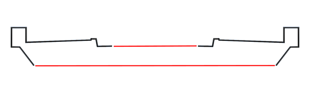

Each element is a segment in the cross-section of the sides of the bridge. Because you chose Spannable Geometry, the elements are mirrored:
Later, you use the Spanning Surface and Closing Surface options to create the roadway at the top of the bridge, and the bridge's bottom. The diagram shows these in red. (You also set up Capping Surfaces at each end of the bridge.)

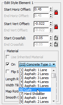

(Add new element) once again. This new element is the vertical face of the curb.
(Add new element) once again. This new element is the top of the curb.

(Add new element). In addition, in the Material sub-group, set the Width Tiling value to 0.2 so the pattern of the new walkway matches the pattern of the roadway on the ground.

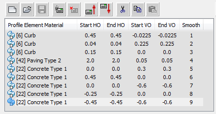

(Add new element) and add five new elements to the swept object style. Use the following table as a guide for the element settings.
| Element number | Horizontal Offset | Vertical Offset | Material ID |
| 5 | 0.0 | 0.3 | [22] Concrete Type 1 |
| 6 | 0.45 | 0.0 | [22] Concrete Type 1 |
| 7 | 0.0 | –0.6 | [22] Concrete Type 1 |
| 8 | –0.25 | 0.0 | [22] Concrete Type 1 |
| 9 | –0.45 | –0.6 | [22] Concrete Type 1 |
When you are done, the element list should show nine elements in all.

3ds Max adds these surfaces to the bridge style: The spanning surface is at the top, the closing surface is at the bottom, and the capping surfaces close the ends of the structure.
