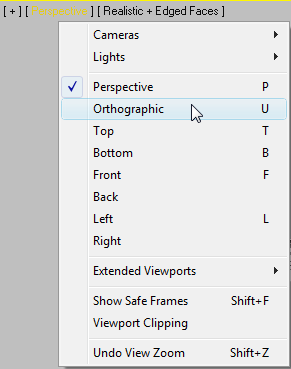

- Click the Point-Of-View (POV) viewport menu and change the view type to Orthographic.
Throughout this lesson, you will need to zoom, orbit, and rotate the view to follow the steps. A Perspective view clips the view of the model, which makes it hard to work. An Orthographic view is easier to navigate for these purposes.

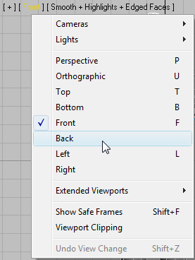

(Maximize Viewport Toggle) to change to a four-viewport layout. Activate the Front viewport, click the Point-Of-View (POV) viewport label menu and choose Back, then press Alt+W again.
