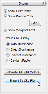

Display rollout and click Export To CSV File.
3ds Max saves the data generated by the Light Meter object in CSV format to the \export folder of your project directory.
The file opens in an Excel spreadsheet, showing light data gathered by each point in the Light Meter helper. This data, formulated for technical specialists such as lighting engineers, is described in detail in the following table.

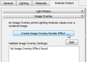

Create an image overlay:
Lighting Analysis Assistant to open the Lighting Analysis Assistant dialog.
3ds Max opens the Environment And Effects dialog

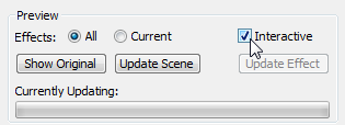

Preview group, turn on Interactive.
3ds Max renders the scene.
As soon as the calculation is complete, two rendered frames display.

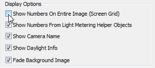

Display Options group, turn off Show Numbers On Entire Image (Screen Grid).
Now only the luminance values returned by the sampling points of the Light Meter you created for the court surface are displayed.

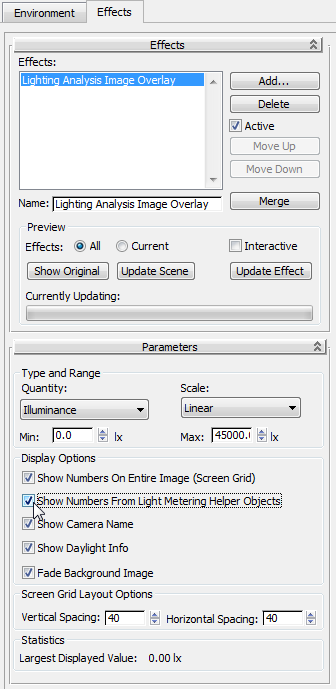

Effects panel
Parameters rollout

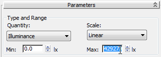

Type And Range group, change the value of Max to 42927.0, and then press Enter. (If your rendering shows a higher Maximum Illuminance value, choose a Max value that is about 10 greater than the value you see.)
By lowering the maximum range, the sample values display in their full color-coded range, from blue (low luminance) to red (high luminance). This is most noticeable near the windows.
The scene shows the actual light intensity of the rendered image. This, however, makes the Light Meter data harder to read.

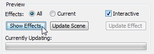

Preview group, click Show Original to view the scene without the lighting data. Click Show Effects to redisplay the data.
