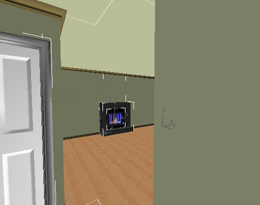

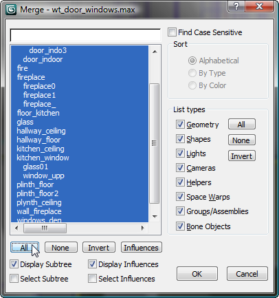

Add the windows, fireplace, and door:
Merge. Browse to the
\scenes\data_exchange\AutoCAD\
folder, choose the file
wt_door_windows.max,
and then click Open. 3ds Max opens a Merge dialog.
Merge adds the door, windows, and fireplace to the scene.

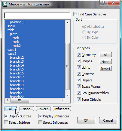

Add the furniture:
Merge once again. In the \scenes\data_exchange\AutoCAD\ folder, choose
wt_furniture.max,
and click Open. 3ds Max opens the Merge dialog.
3ds Max merges chairs and some decorative elements into the scene. (The merged scene also includes a sky dome, which supports distant scenery and snow falling, seen through the windows.)
