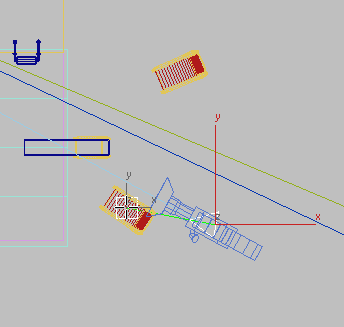

You will use the Tape helper to determine the distance between the camera and three objects in the scene: a chair, a flower pot, and a corner of the building. The location of each object will become a focal plane, or region where the scene is in the sharpest focus.
On the Parameters rollout, the Length field displays the distance between the two objects as roughly 2.3 meters.
The Length field displays a length of about 20 meters.
The Length field displays a length of about 28 meters.
