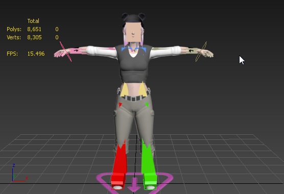

The scene is the Emma character we also used in Skinning a Character. For this lesson, Emma has been moved into a standard T-pose, which MotionBuilder requires. Emma has a CAT character rig, but the rig has been hidden. So far, there is no animation.
- Right-click the viewport, and from the quad menu choose Unhide All.

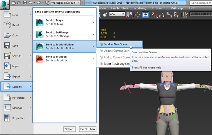

Send the scene to MotionBuilder:
- Open the
Application menu and choose Send To
Send To MotionBuilder
Send As New Scene.
3ds Max displays a warning that no objects have been selected.
- Click Yes to send the entire scene.
