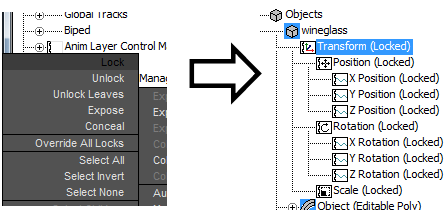

Lock an object’s transforms:
Say the originator is now happy with the wine glass’s position and doesn’t want it change any more. The ability to lock specific parameters of a container definition is an important Container feature.
Track View opens showing the container hierarchy.
top-left quadrant, choose Lock. The Transform entry and all its children (branches and leaves) now show “(Locked)” after their names in the Track View hierarchy.
You can move everything except the wine glass.
The Transform track is no longer locked, but its child tracks still are. Lock affects child tracks, but Unlock affects only highlighted tracks.
+Z) to restore the the Transform track to Locked status. This unlocks the Transform track as well as all of its child tracks. Now you can transform the wine glass if you want.
