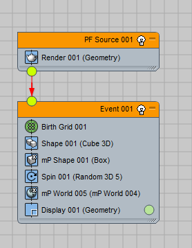

When you begin learning to simulate particle physics with Particle Flow, the included preset mParticles Flow makes a good starting point. In this tutorial, you use the mParticles Flow in conjunction with other techniques for learning how to use the mParticles system.
Skill level: Intermediate
Time to complete: 1 hour
In the initial sections of this tutorial, you start from scratch, but the final section uses a prepared .max scene file.
This adds in one fell swoop all the necessary elements for a simple physics simulation.

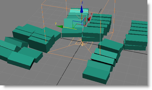

It starts out with a cubic arrangement of box-shaped particles suspended in mid-air. The particles quickly fall to the ground and end up randomly scattered around the point of impact.
The boxy particles don't do much after they fall, but you can add some rolling action by making them round.
mParticles Shape determines the particles' characteristics during the simulation.
This time the particles fall and then disperse by rolling away.

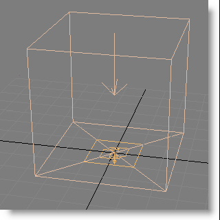

The physics-simulation engine is the mParticles World helper, which you can access from Particle View.
This selects the helper and shows its Parameters rollout on the Modify panel.
This time, when you play the animation, the spheres fall much more slowly and take longer to roll away.

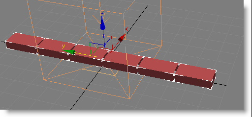

In this section you'll create a simple brick wall and use virtual glue to mortar the bricks.
Birth Group replaces Birth Grid and the particles disappear from the viewports. However, the large wireframe cube remains. This is the mParticles World helper. The down arrow pointing to its center indicates the direction of gravity, and the X on the bottom side indicates the location of the ground collision plane. By default, this coincides with the home grid in 3ds Max (the XY plane at Z=0).
There is no physical sign of Birth Group in the scene; it creates particles from mesh objects that you specify, as you'll see shortly.
The operator isn't necessary for this tutorial.
The Box object names now populate the list, and their particle counterparts appear in the viewports. The boxes are the particle objects; once you've applied them to the operator, you can get them out of the way easily.
This hides the objects in the list, leaving only their particle counterparts.
Now the mParticles Shape 001 (Box) operator governs the shape of the particles, so they are the same size as the original bricks.

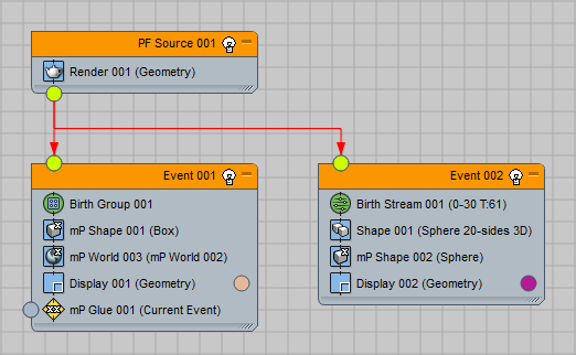

To create particle interaction, you'll add a Birth Stream emitter.
You also need to clone the mParticles World operator so both events use the same mParticles World helper and world setup. You'll do this in a little while.
The read-only Total field should now contain 1.

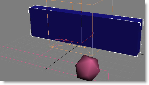

If you play the animation now, you see the single particle come shooting out from under the wall. That's because the default position of the Birth Stream icon is at the world center: (0,0,0). Also, because Birth Stream has a Speed property built in, set to 300 by default, no additional Speed operator is necessary.
The sphere goes through the wall without colliding with the bricks. That's because its event isn't participating in the physics simulation yet.
An mParticles World operator needs to be in every event whose particles participate in the simulation. It should always be the last operator in the event except for Display and any tests.
3ds Max adds an mParticles World event to the sphere event.

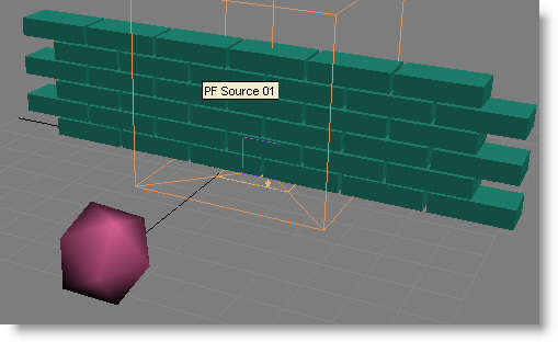

Birth Group operator and then click Unhide to reveal all the mesh shapes used to generate the particles. Then turn off the Birth Group operator so you can see the boxes more easily.
This, of course, is how real-world brick walls are constructed. Also, in the real world, half-bricks are used to fill in the gaps, but that won't be necessary for this tutorial. In fact, in this section you'll make the bricks act like planks, further demonstrating that in the virtual world, anything is possible.
Turn the Birth Group operator back on.
The particles are still in their original positions. If you change the particle objects (the boxes), you need to update the Birth Group manually.
You can see more connections now, mainly because of the offset alternate layers. There were as many before, but now they go diagonally to get to the nearest brick, whose horizontal position is offset.
This eliminates all the diagonal bindings by allowing mParticles Glue to bind only to particles whose local axes are aligned with each other. So bindings can go only at right angles (the way the axes line up), not diagonally.
If you look closely, you can see the horizontal bindings between neighboring particles and the vertical bindings between particles in alternating layers. To create the plank effect, you use a third setting to eliminate the latter.
Bind Gap eliminates bindings beyond the specified distance, so the long-distance bindings between alternating vertical layers, which are much longer than the specified Bind Gap value of 1.0, are no longer enabled. You're left with horizontal bindings only, which provide the desired plank effect.
After you turn on Bind Gap, if you don't see the small horizontal bindings between boxes, increase the Bind Gap value until the bindings reappear.

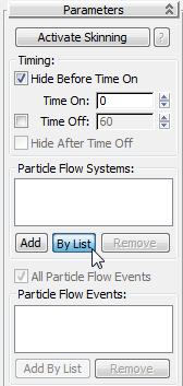

Particle Skinner is a powerful modifier that lets particles function as "bones" inside a mesh "skin." As you'll see in this brief introduction, this allows for some quick and easy but exciting possibilities for special effects.
For this lesson, you'll go back to the particles that break up as columns.
mParticles Glue operator, turn on Visualize Binding, then set Bind Distance to a low enough value that only vertical bindings appear. A value of 10.0 should work. The problem is that, as there's only one ball, only the center columns are affected by its impact. One way to resolve this is to have more particles.
Now the Total value is 3, but if you play the animation, the balls are too close together, and still don't affect all the columns. You can adjust their placement with the Uniqueness Seed value.
Not all of the columns are hit, but enough are that they all end up in different positions.
In the included sample scene, pflow_mparticles_tutorial.max, the size is 127 x 12 x 34, but this might vary in your scene.
On the Select Particle System dialog, click to select PF Source 01, and then click OK.
The Particle Flow Systems list now contains a single entry: PF Source001. However, not all the particles in this system should affect the box "skin"; just the ones in Event 001.
Particle Skinner works by letting particle motion exert an influence on nearby mesh points. Ideally, all mesh points in the modified object should be influenced by particles; otherwise, they get left behind when the particles move, causing unsightly stretching of the mesh. Thus, a useful option is the ability to check for uninfluenced mesh points, which helps you to set the influence distance to the right amount.
