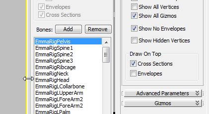

Drag the left edge of the command panel to the left to expand it to multiple columns.
Bones appear as straight lines with vertices at the ends.

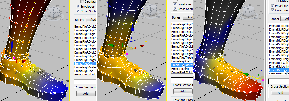

From left to right: calf, ankle, and toe bone selected.
End with EmmaRigLAnkle selected. The shading (orange, yellow, and blue) indicates that most of the vertices’ weights for this bone are less than 0.5, which is undesirable.

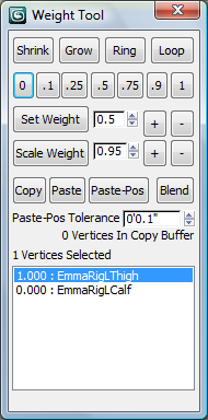

In this section you’ll continue to block out the leg weighting, using the convenient, powerful Weight Tool dialog.
Given a selection of vertices with the same bone and weight assignments, Weight Tool lists all bones that affect the vertices along with the corresponding Weight values. It also lets you edit the Weight value for the current vertex selection and bone assignment, setting either an absolute Weight value or adjusting the weights of the vertices relative to their current values. In addition, Weight Tool provides controls for copying and pasting Weight values and controls such as Ring and Loop for modifying the vertex selection.
The Weight Tool dialog opens. Drag it to a convenient, out-of-the-way location. You can keep it open as you work.
The list shows the selected vertex’s bone assignments and the Weight value for each assignment. Note that the Weight values always add up to 1.0. If, for example, you change the Weight value for a particular bone for a vertex that’s influenced by three different bones, 3ds Max changes the values for the other two bones in the opposite direction, in proportion to their current values.
Note also that the Set Weight value doesn’t change; this is a write-only field.
This sets the Weight value for all selected vertices to 1.0 with respect to the calf bone. Note that the weights for the other two bones in the list are now 0. You can get rid of 0 weights in the entire mesh by clicking Advanced Parameters rollout
