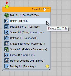

Set up the scene:
Change the particle geomery:
Unlike the blue line that appears when you add an operator by dropping the operator between two others, the line for replacing an operator appears red.

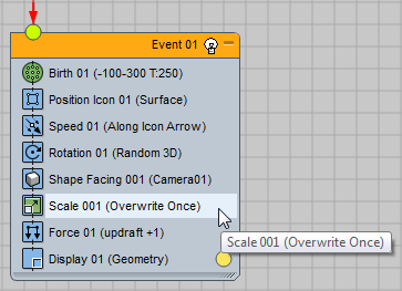

Set the particles to grow over time:
The smoke particles should grow over time: As the smoke rises, it also disperses. To model this, you use a Scale operator.
X % to 100.2.
Because Constrain Proportions is on, the Y % and Z % factors update to 100.2 as well.
The factor by which the particles grow doesn’t need to be great. Even two-tenths of a percent increase at each frame adds up quickly.
The particles increase in size as they rise.

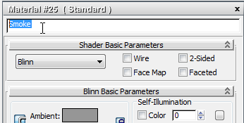

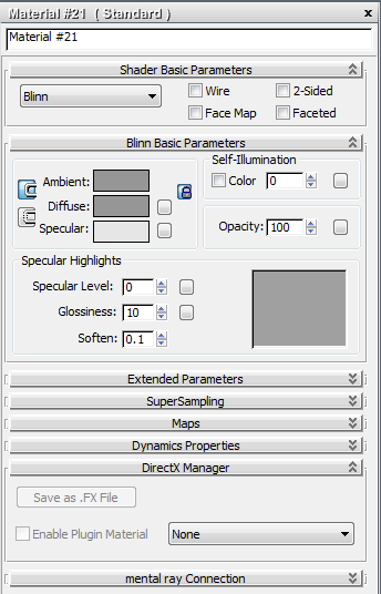

Create a dynamic material for the particles:
The next step is to create a material that changes over time while the particles change in size.

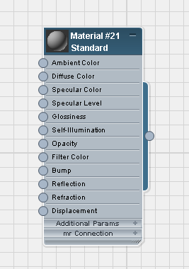

Standard
Standard, and drag the Standard material entry into the active View.

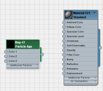

Standard

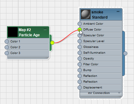

Particle Age, and drag the Particle Age entry into the active View.

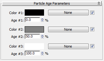

The Particle Age map specifies three colors: By default, Color #1 is the color at a particle’s birth (0 percent), Color #2 is the color when the particle is halfway through its life (50 percent), and Color #3 is the color at the particle’s death (100 percent). You can change the ages, but we won’t do so in this tutorial.
Don’t worry about the precise values: These are just arbitrary colors to test the Particle Age effect. Once Particle Age is working as we want it to, you will replace the colors with more realistic patterns.

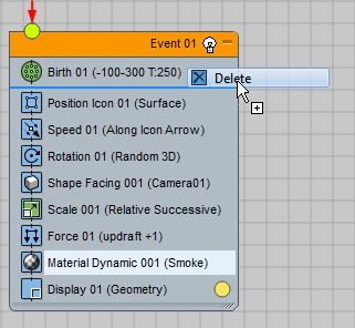

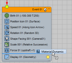

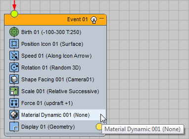

Add the new material to the particle system:
3ds Max opens a modal version of the Material/Map Browser.
The particles still have a uniform yellow (birth) color.
The reason for this is that the particles don’t yet have a defined life span. The Birth operator controls particle creation, but not particle death.

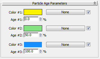

Define the life span of particles:
By Particle Age.
Choosing By Particle Age enables the Life Span and Variation parameters.
The Variation setting introduces a random variation in the life span of particles, so the system doesn’t appear too uniform.
The particles begin with a yellow color, which shades to green at their half-life, and then to blue as they near the end of their existence.
