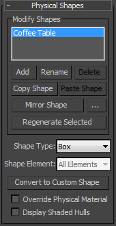

Select the Coffee Table object.
A static rigid body is part of the simulation, but otherwise it doesn't move or change.
Modify panel. MassFX sets up objects by applying a modifier, MassFX Rigid Body, to the objects you choose.
MassFX works with two kinds of geometry:
Typically, you use graphical meshes (Original) for Static bodies, which do not move in the simulation.
Typically, you use physical shapes for all moving bodies in the simulation.
The rule of thumb is to use the simplest geometry you can get away with. In this case, the coffee table is a simple box that is static, so Original will work fine. Open the Shape Type drop-down list and choose Original.

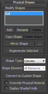

Set up the ball:
Select the Ball object.
Dynamic rigid bodies are the objects that move under physical forces. In the case of the ball, the force is gravity.
Physical Shapes rollout, check the Shape Type.
The default mesh type for most dynamic bodies is Convex. This is a fair approximation of the shape of the ball, as you can see in the viewports.
Convex physical shape approximates the ball
Note: Mesh Transform sub-object level was used to offset the physical shape for clarity.
However, the default shape is not one that will roll very well. The MassFX Rigid Body modifier has a better shape for spherical objects.
Now the physical shape matches the shape of the original ball.

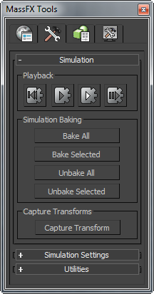

Bake the animation:
"Baking" a procedural animation involves recording the transforms of each object in the animation as keyframes. Typically this is done on a frame-by-frame basis, resulting in a renderable animation that is identical to the original simulation.
(World Parameters). 3ds Max opens the MassFX Tools dialog to the World Parameters panel.
(Simulation Tools) tab.
3ds Max converts the simulation to keyframes. While doing so, it displays a progress bar at the bottom of the window.
Once the baking is complete, you can play the simulation as a regular animation, by clicking
(Play Animation) near the lower-right corner of the 3ds Max window. You can also render the baked animation to a video file. And if you want to go back and tweak the simulation, you can unbake any or all objects.
