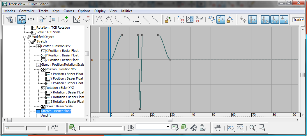

Animate stretching and squashing:
The Stretch field’s spinner arrows now show red brackets, indicating that 3ds Max has created an animation key for this parameter. In the viewports, you can see that the basketball is elongated along its direction of travel.
This squashes the basketball at the point of impact. Incidentally, it also corrects the way the basketball used to sink into the floor.

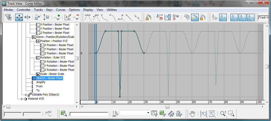

Shift+copy the key at frame 6 to the following frames:
Repeat the stretch and squash:
controller window, locate the track for the Stretch parameter. The hierarchy looks like Basketball
Modified Object
Stretch
Stretch : Bezier Float. You have to scroll down to get past several position, rotation, and scale tracks that you arent using in this exercise.
Now the squash and stretch pattern repeats indefinitely.
