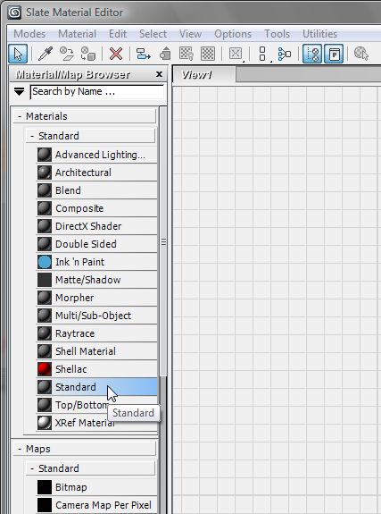

- In the Material/Map Browser column at the left of the Slate Material Editor window, locate the entry for a Standard material.
Drag this entry to the large View panel (View1) at the center of the window. 3ds Max displays the material as a node in the View.

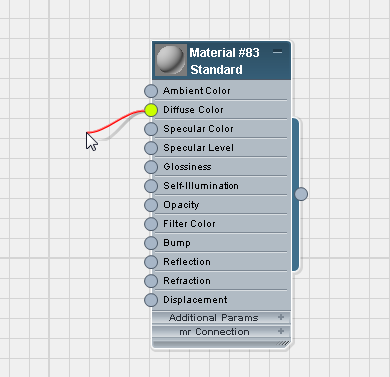

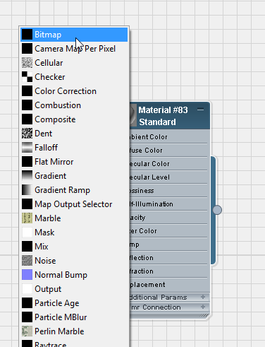

- Click the round input socket for the material's Diffuse Color component, then drag away from it.
A wire appears as you drag.
Release the mouse.
3ds Max opens a pop-up context menu.
On the context menu, choose Bitmap.

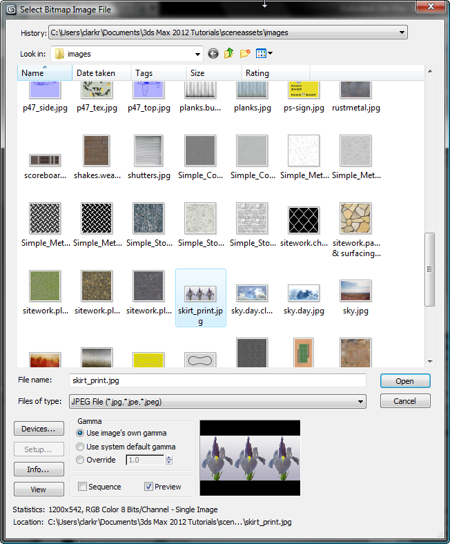

3ds Max opens a Select Bitmap Image File dialog.
On the file dialog, click
to select it, then click open.

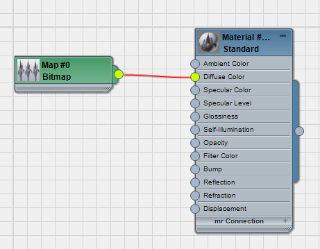

3ds Max adds a Bitmap node to the material's Diffuse Color component.

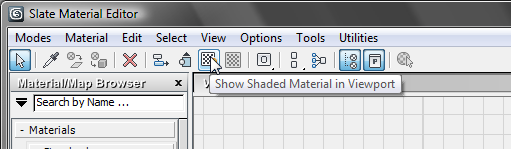

- Click the bitmap node to select it.
- On the Slate Material Editor toolbar, click to turn on
(Show Shaded Material in Viewport). (If you are using a legacy driver, Direct3D or OpenGL, the tooltip says, "Show Standard Map in Viewport.")
When this option is turned on, 3ds Max displays a red wedge in the title bar of the Bitmap node.

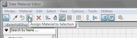

- Move the Slate Material Editor window so you can see a viewport. In the viewport,
click to select the skirt (Skirt Pattern) object.
(Assign Material to Selection).
Close the Slate Material Editor. Shaded viewports now show the pattern on the dress. This is a good start, but the flowers should appear vertically and more evenly spaced.

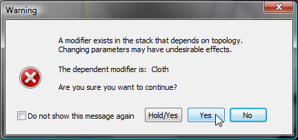

- On the modifier stack, scroll down so you can see the Garment Maker modifier, and click the Garment Maker entry to highlight it.
3ds Max displays a warning about topology. Click Yes to dismiss this warning.

If 3ds Max displays the topology warning again, click Yes to dismiss it again.

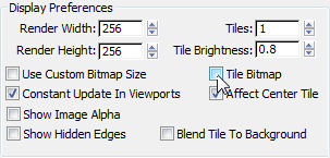

- In the Unwrap Options dialog
Display Preferences group, if Tile Bitmap is off, click to turn it on, and if Use Custom Bitmap size is on, click to turn it off.
Click OK to close the Unwrap Options dialog.

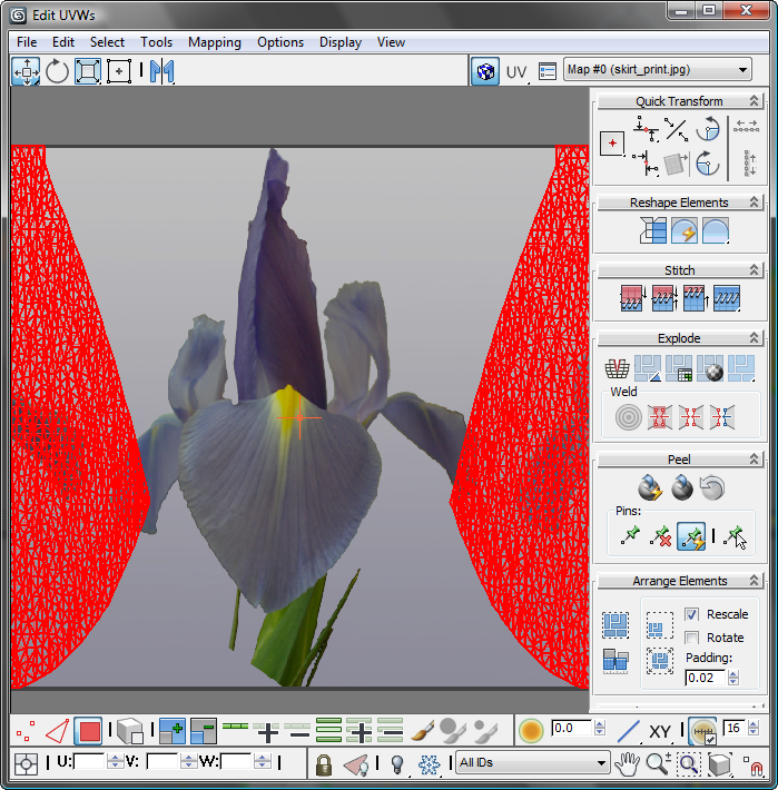

The area in the Edit UVWs window outlined by a dark rectangle is a unit square for the UV coordinates (it appear rectangular in this case, because the bitmap is not square).
- Resize the Edit UVWS dialog, then
zoom and
pan the Edit UVWs window so you can see two tiles of the flower pattern. Navigation tools are on the Edit UVWs dialog
second lower toolbar, the Transform/Display toolbar. They appear in the lower-right corner of the dialog.

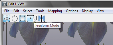

- On the Edit UVWs dialog
upper toolbar, click
(Freeform Mode) to activate it.
In Freeform Mode, the sub-object selection is surrounded by a box. Dragging the center of the box moves the selection; dragging a handle in the middle of a side rotates it; and dragging a handle at a corner scales the selection, relative to the texture you are mapping. Watch the cursor to see which transform is active.
- Move the skirt group to align it with the left edge of the pattern, then scale to stretch it so it covers two tiles of the pattern.
- Click an empty area of the Edit UVWs window to deselect the skirt panels.
- On the first of the Edit UVWs dialog
lower toolbars, the Sub-object Selection toolbar, click
(Select by Element UV Toggle) to turn it on.
When it is on, the button shows a check mark.
- Click to select only the left-hand skirt cluster, and scale it so it spans the first tile of the pattern.
- Do the same for the right-hand skirt cluster.
