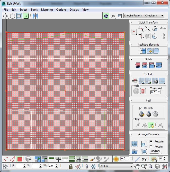

  6. On the Modify panel Edit UVs rollout, click Open UV Editor.
    3ds Max opens the Edit UVWs dialog.
  7. On the Edit UVWs dialog toolbar, choose “Map #11 (fac1.jpg)” from the background pattern drop-down list. (The map number might vary.)
    Now the main window of the dialog displays fac1.jpg.
  8. On the second of the lower toolbars, the Transform/Display toolbar, click to turn on (Display Only Selected Polygons).
    Now the geometry shown in the Edit UVWs dialog (the red mesh) represents only the left-hand doorjamb face.
  9. On the Edit UVWs dialog toolbar, click (Freeform Mode) to activate it.
    The face mesh now shows handles at its edges and corners. With Freeform Mode, you can scale the face by dragging a corner handle, rotate the face by dragging a side handle, and move the face by dragging from the interior of the face.
  10. Drag a corner to scale the face so it is roughly the size of a doorjamb in the bitmap.
    Tip: Move the Edit UVWs dialog so you can also see the left doorjamb in the viewport. That way, you can see your texture-mapping changes interactively, as you make changes in the dialog.
  11. In the Edit UVWs dialog, drag the face to the right, so it covers the right side of the central pillar.
  12. On the Edit UVWs dialog toolbar, click (Mirror Selected Subobjects).
    In the viewport, you can see how the correction looks.
This is the pattern for using Unwrap UVW to correct textures on faces with poor texture projection: Essentially, you “fake” the texture by choosing some part of the original texture that looks well when applied to the surface that needs correcting.
