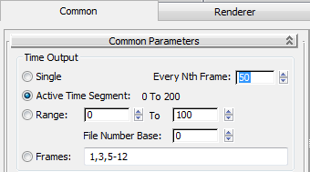

Common panel, on the Common Parameters rollout, find the Time Output group. Change the output from Single to Active Time segment, and then change Every Nth Frame to 50.
This will render five frames that are sampled along the duration of the animation, from frame 0 to frame 200. (Rendering five frames will take probably 5 to 10 minutes: Adjust the Every Nth Frame value to suit the time you want to spend on this lesson.)
