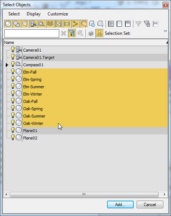

Choose the trees with which you will paint:
3ds Max opens a Paint Objects dialog.
3ds Max opens a Select Objects dialog.
The grove you paint in this lesson will be an eclectic one. Another time, you might want to choose only spring trees, for example, or fall ones.
Now you are able to paint the trees onto the terrain. By default, the Paint Objects tool uses the first object in the set you selected.

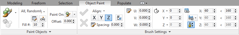

Set up the Object Paint tool:
When you paint, the trees will appear in random order.
We want the trees to grow vertically, not to lean wherever the terrain is not flat.
In the Brush Settings panel
Rotate group, click the drop-down arrow next to the Z coordinate field, and in the drop-down list, turn on Random Z.
When you paint, the trees will have a random amount of rotation about their vertical (Z) axis.
Scale group, make sure
After you choose Random, the Scale group shows a range of values for the axes; because Axis Lock is on, you can change only the X axis values.
The trees will vary in height and girth from 60 units to 160.

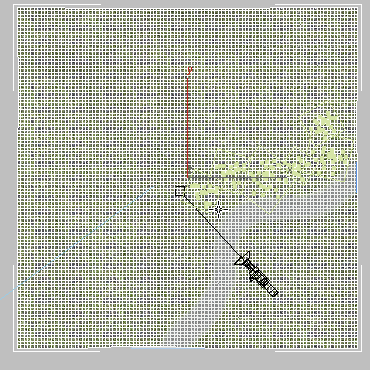

Now you are ready to begin painting trees.
Paint the proxy trees:
Remember that Object Paint is set to paint onto the currently selected object.
(Paint With Object(s) In List) is now active.
You can paint the trees densely together, but on the near bank of the stream, avoid painting directly in front of the camera’s line of sight.
3ds Max removes the trees you painted, allowing you to start over.
3ds Max adds the trees to the scene, as copies of the original tree proxy objects.
