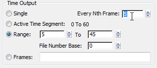

3ds Max opens the Render Setup dialog. The Common panel is active.
Time Output group, set the range from frame 5 to frame 45 (0800 to 1600 hours). Also set Every Nth Frame to 5.
You will render nine snapshot frames over the course of the main daylight hours.
