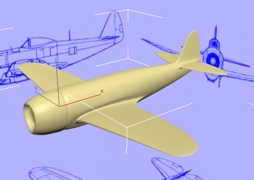

Use NURMS again to check your work:
  1. Press Alt+X to turn off X-Ray display, then on the ribbon Edit rollout, turn on (NURMS). On the Use NURMS panel, increase the number of iterations to 2.
  2. Activate the Perspective viewport, and press F4 to turn off Edged Faces.
    The smoothed model shows that the wings are successful.

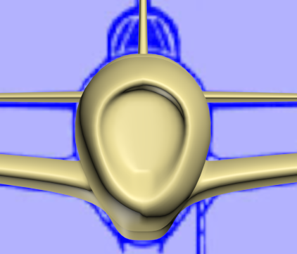

  3. Zoom and pan the Left viewport so you have a good view of the air intake. Press F4 to turn off Edged Faces.
    Two edges at the lower edge of the intake are sharper than they should be: These come from the additional contour you created with Swift Loop when you were preparing to extrude the wings. You will correct these in the next procedure.
  4. Click (NURMS) again to turn it off.

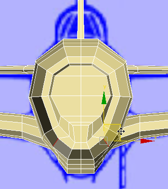

Correct the air-intake edges:

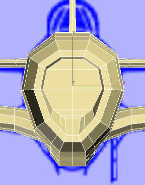

  1. In the Front viewport, press F4 to turn on Edged Faces again.

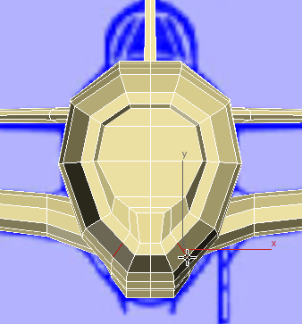

  2. Go to the (Edge) sub-object level. On the very front of the engine cowl, select the new edge that is to the lower right of the viewport.
  3. On the ribbon Edit panel, activate (Constrain To Edge), then move the edge upward to about the center of the face it is on.

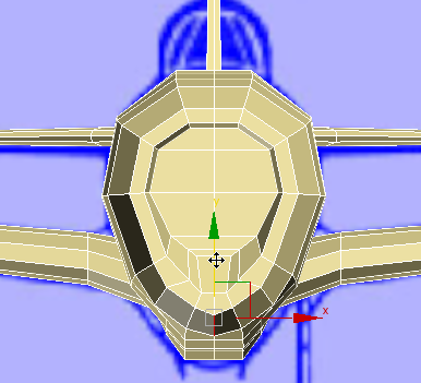

  4. On the ribbon Edit rollout, activate (Constrain To None), then move the edge again, outward this time, so the intake portion of the engine cowl is a bit more rounded.

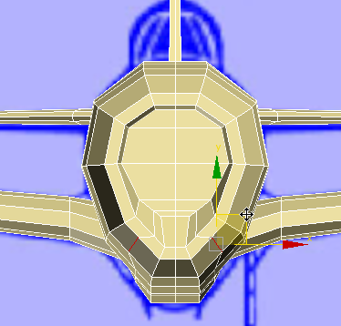

  5. Select the center edge at the bottom of the front of the intake, and move it down along the Y axis.

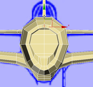

  6. Select the corresponding edge at the top of the intake, and move it up slightly along the Y axis.
  7. Deselect all edges.

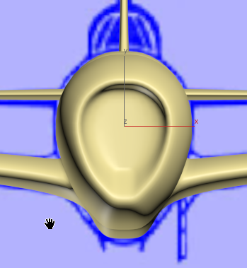

  8. Turn on (NURMS) again, and press F4 to turn off Edged Faces.
    Now the intake portion of the cowl looks a good deal better.
