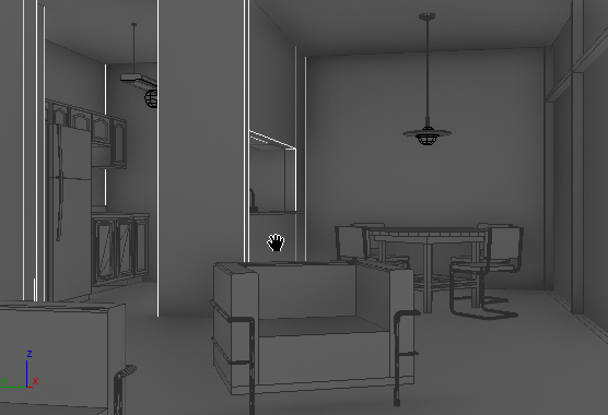

Create an interior view:
The benefits of a Sky Portal become most apparent when you adjust the interior daylight settings. You will do so soon, but first you need to create another camera to view the interior of the bungalow.
Camera002 to switch to the viewpoint of the camera you just created.

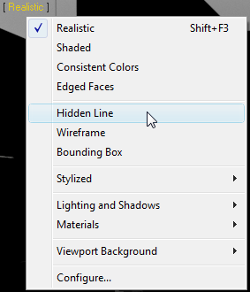

Hidden Line display makes it easier to frame the scene. The Shaded option can also help, as it doesn't use lighting levels.
The Hidden Line option is available only when you use the Nitrous viewport driver. If this option is not available on your system, then the dark viewport is probably not an issue; if it is, press F3 to see the view in wireframe mode.
Adjust the exposure and render the interior:

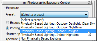

The preview looks overexposed. To improve the rendering, you need to adjust the scene’s exposure settings.
Exposure group, change Shutter Speed to 32.0 (1/32 Sec.). The preview thumbnail updates dynamically to reflect your change.

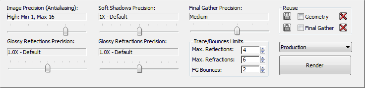

With the Sky Portal turned off, you can see how poorly the daylight is illuminating the room. One way to improve illumination without using the Sky Portal is by increasing the number of light ray bounces.

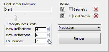

Add Final Gather to improve the lighting:
The interior is brighter now. However, the kitchen area remains unnaturally dark. This is where the Sky Portal comes in.

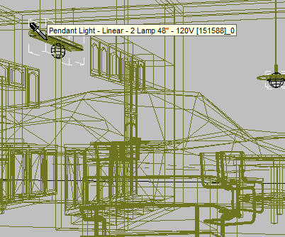

Before you render the scene again, you will make a slight adjustment to the light object in the kitchen.
The light appears to be on, but it provides no illumination. This is because, while the light object is turned off like all others in the scene, its material is set to glow. This is a characteristic you will require later when you render the scene with artificial lights turned on.
For now, you need to adjust the light’s material.

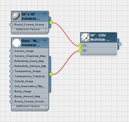

Correct the self-illuminating kitchen light for a daylight scene:
3ds Max displays the material nodes in the active View.
The material for the light assembly is a Multi/Sub-Object material with two sub-materials.
The material reverts to a transparent appearance.

This image was produced with shadow samples set to 512 and the following render frame settings:
The image is improved, but it requires considerably more time to render.

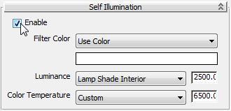

Restore self-illumination to the kitchen light:
You need to do this step because in the next lesson, you will illuminate the bungalow using the man-made lights you imported from the Revit scene.
