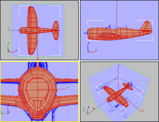

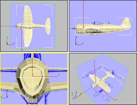

Set up the lesson:
Set up the viewports:

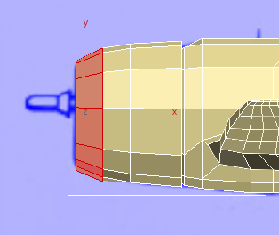

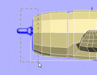

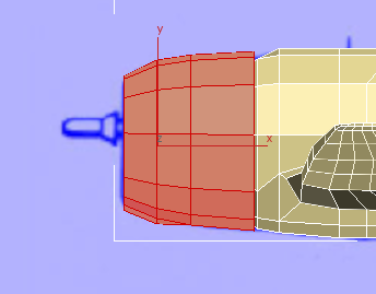

Smooth the engine cowl:
Properties panel
drop-down portion, click 3ds Max opens the Smoothing Groups dialog.
This removes any default smoothing-group values that the faces might have.
Leave the Smoothing Groups dialog open: You will be using it throughout this lesson.
Modify Selection panel, click
3ds Max smooths the faces of the engine cowl.

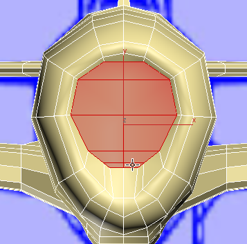

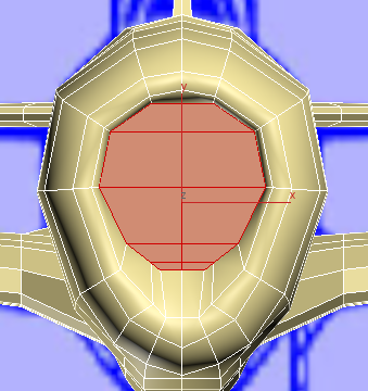

Remove smoothing from the air intake:
In this procedure, you don’t really remove smoothing from these faces: You just assign them to a different group from the rest of the cowl.
Now the air-intake faces look flat.

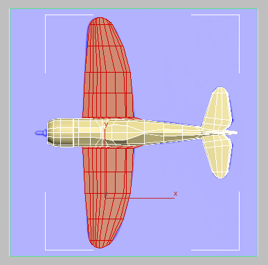

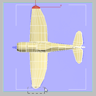

Smooth the wings:
Perspective view

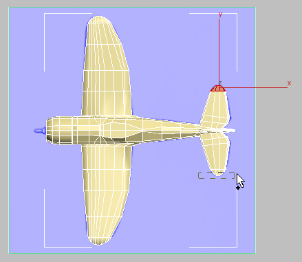

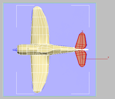

Smooth the horizontal stabilizers:
The steps for the horizontal stabilizers are almost the same as those for the wings.

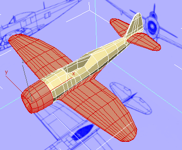

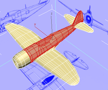

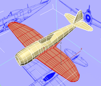

Smooth the remainder of the fuselage:
Now all of the model is smoothed correctly, except for the main fuselage. You can use the smoothing groups you’ve already created to help select it.
3ds Max opens a Select By Smooth Groups dialog. The buttons show only those smoothing groups that you’ve assigned so far.
3ds Max selects those faces that already have a smoothing-group value assigned.
Now only the fuselage and tail are selected.

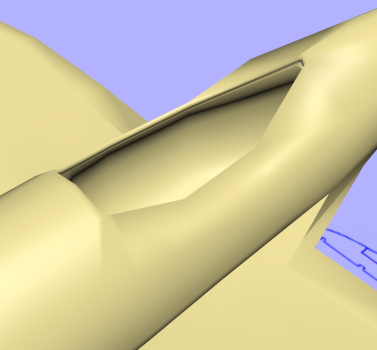

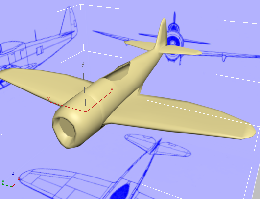

Smoothing the fuselage has an unexpected effect: The faces around the cockpit are indented too deeply. You can use the Smoothing Groups dialog to fix this.
Unwanted indentation around the cockpit
(This is easier to see when the polygons are not selected, but you don’t need to deselect the polygons in your scene.)

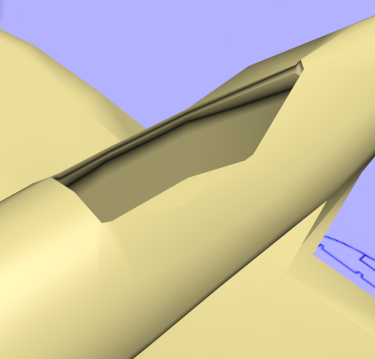

3ds Max corrects the indentation around the cockpit.
Increasing the threshold value increases the chance of two faces to be smoothed together.

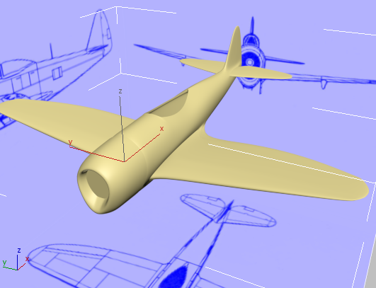

Use smoothing groups with NURMS smoothing:
Edit panel, turn on
Use NURMS panel, increase the number of iterations to 2. The default NURMS smoothing ignores the smoothing groups, and blends all faces of the P-47 together.
Use NURMS panel
drop-down portion, open the Separate By drop-down list, and turn on Smoothing Groups.
With smoothing groups taken into account, NURMS correctly shows seams between the air intake and the rest of the engine cowl, and between the wings and stabilizers and the main fuselage.
Although the smoothing provided by smoothing groups alone is not as good as NURMS smoothing, it could work for a low-polygon environment such as a game engine, or for viewing the model in a medium or long shot.
