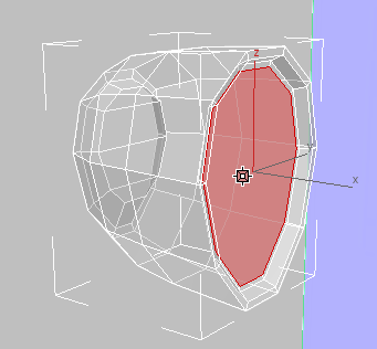

Build the forward part of the fuselage from the rear of the cowl:

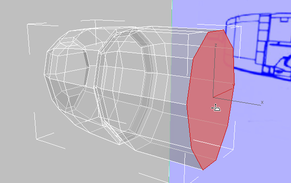

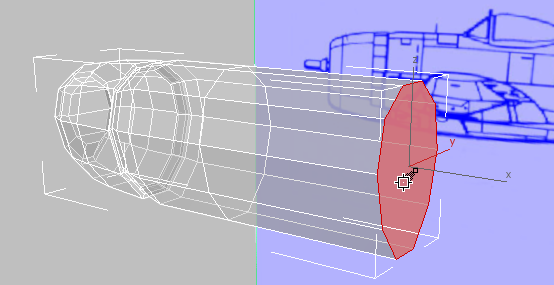

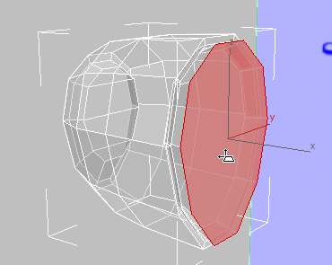

  1. On the ribbon Polygon Modeling panel, click to activate (Polygon). In the Perspective viewport, click the polygon at the rear of the cowl to select it.

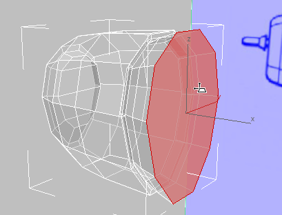

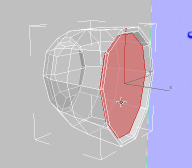

  2. On the ribbon Polygons panel, click (Inset). In the Perspective viewport, drag downward to create an inset with very narrow border polygons.

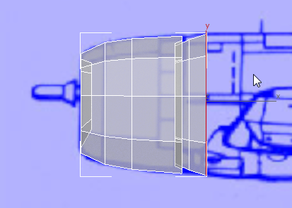

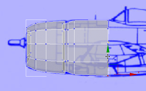

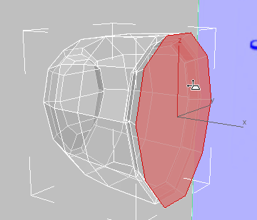

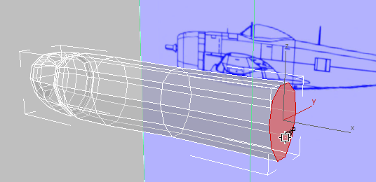

  3. On the ribbon Polygons panel, click (Bevel). In the Perspective viewport, drag upward this time to extrude the polygon toward the rear of the airplane. Watch the Front viewport while you're doing so, and extrude the polygon just beyond the area of the cowl.

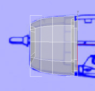

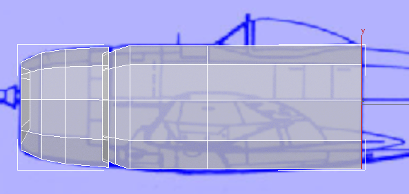

    Front view
    Release the mouse, then drag upward again to scale the bevel so it is almost the same diameter as the cowl itself. Again, watch the Front viewport while you work.

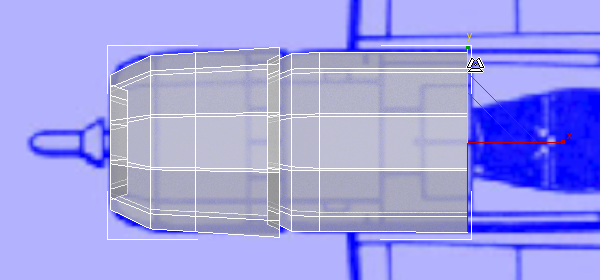

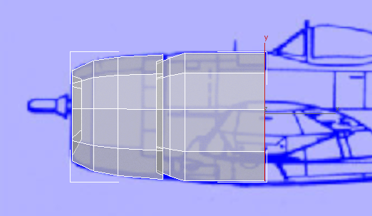

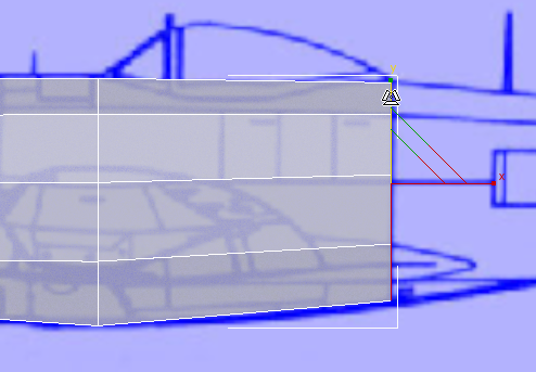

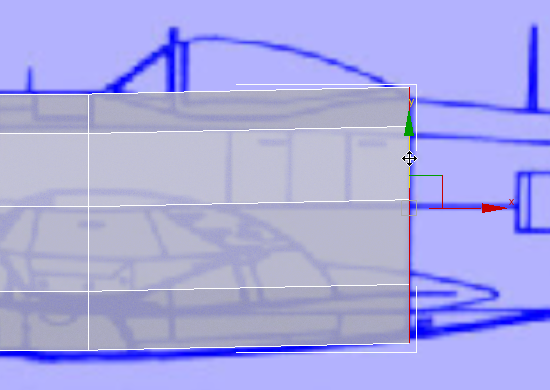

  1. Use (Bevel) again to extend the fuselage up to the leading edge of the rectangular panel in front of the cockpit, then scale it up so that in the Front view, it follows the contour of the blueprint image.
    Front view

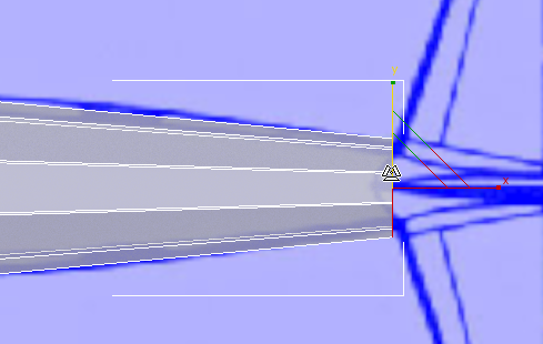

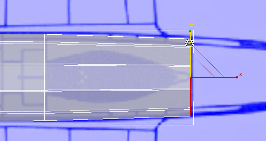

    This looks good, but if you look at the Top viewport, you can see that the new bevel is a bit too wide.
  2. Activate the Top viewport, then scale the polygon down along the Y axis to align it with the blueprint image.

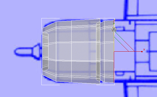

  4. On the ribbon Polygons panel, click (Extrude). In the Perspective view, extrude the fuselage up to the leading edge of the cockpit. As usual, watch the Front viewport while you work.
    Front view

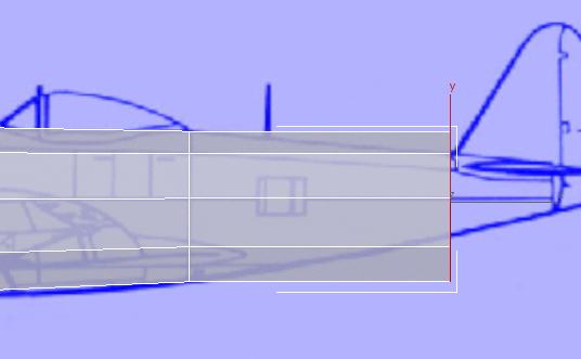

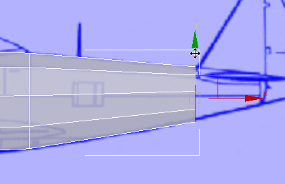

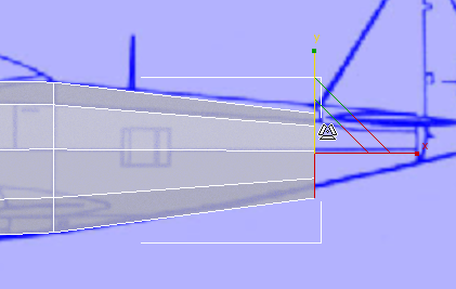

  1. On the ribbon Polygons panel, click (Extrude) once more. Then extrude the fuselage as far as the leading edge of the tail.
    Front view
  2. In the Top viewport, scale the polygon down to match the contour of the airplane.
  3. In the Front viewport, scale the polygon down to the size of the contour.
  4. Also in the Front viewport, move the polygon to better match the blueprint image.
