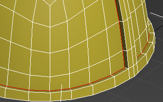

- On the Modify Selection panel of the ribbon, click Loop Mode to turn it on.

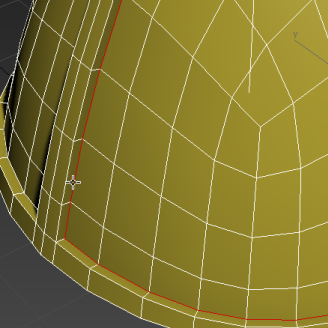

- In the Perspective viewport, click one of the inside-corner edges of the extruded rim.
This selects all edges on the loop.
- Ctrl+click one of the inside-corner edges of the extruded ridge.
This adds the edge's loop to the selection.
- Do the same for the equivalent edge loops on the other side of the helmet.
- On the Edit Edges rollout of the Modify panel, set Crease to 1.0.

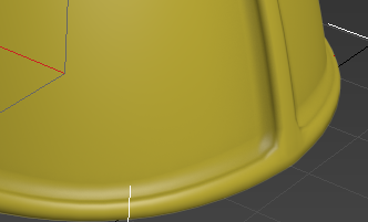

- Apply the OpenSubdiv modifier and, if necessary, press F4 to turn off Edged Faces display.
The inner edge of the extruded polygons is sharper, but it could be more clearly delineated.
The way to do this is to increase the OpenSubdiv Iterations value.
- On the General Controls rollout of the OpenSubdiv modifier, click the spinner up-arrow of the Iterations setting.
The value changes to 2 and the crease becomes a bit sharper. This is because the added resolution allows better definition of fine details such as corners.
- Increase the Iterations value to 4.
The crease is now sharp enough. In general, when using OpenSubdiv, use the lowest practical Iterations value to avoid overly complex meshes.
