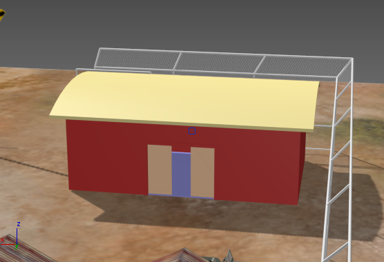

Use the front-door texture for the walls and doors of the barn:
  1. Click the Perspective viewport label, and choose Cameras Camera03.
    Camera03 shows a view of the barn.
  2. Click the viewport label again, and choose Perspective, so any navigation you do won’t change the camera position or settings.
  3. From the Material Editor, drag from the output socket of the WoodBoards material onto the barn walls and barn doors: the objects Barn, Barn-Door-right, and Barn-Door-left.

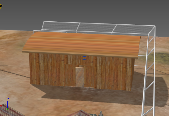

  4. On the Scene Explorer panel, select the Door object.
  5. On the Modify panel Ctrl+drag the Door's UVW Mapping from the modifier stack to the barn wall and door objects.
Use the barracks floor material for the floor of the barn:
  1. From the Material Editor, drag from the output socket of the BarrackFloors material onto the barn floor.
  2. On the Scene Explorer panel, select one of the barracks floor objects.
  3. On the Modify panel, Ctrl+drag the floor object's UVW Mapping from the modifier stack to the barn floor.
Texture the roof of the barn:
  1. From the Material Editor, drag from the output socket of the WoodBoards material onto the barn roof.
  2. Select the barn roof and apply a UVW Map modifier to it. Leave the map projection set to Planar. In the Alignment group, change the alignment axis to Y. In the Mapping group, change Length = Width = 4.0m.
Now the army compound scene is completely textured.
