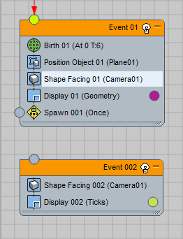

- In Event 001, click to highlight the Shape Facing 001 operator, then right-click it and from the pop-up menu, choose Copy.
- Right-click an empty area of the event-display area below Event 001, and from the pop-up menu, choose Paste.
3ds Max creates a new event, called Event 002, with an operator that also instructs the particles to face the camera. Now you will modify this operator so that the particles will face the scene light source instead of the camera.

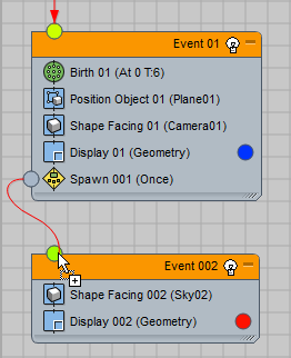

- Click the blue handle to the left of the Spawn operator and drag it to the Event 002 input (the empty circle that protrudes from the top of Event 002).
With this connection, Event 001 spawns a set of particles once and sends them to Event 002, where they are instructed to face the sun.

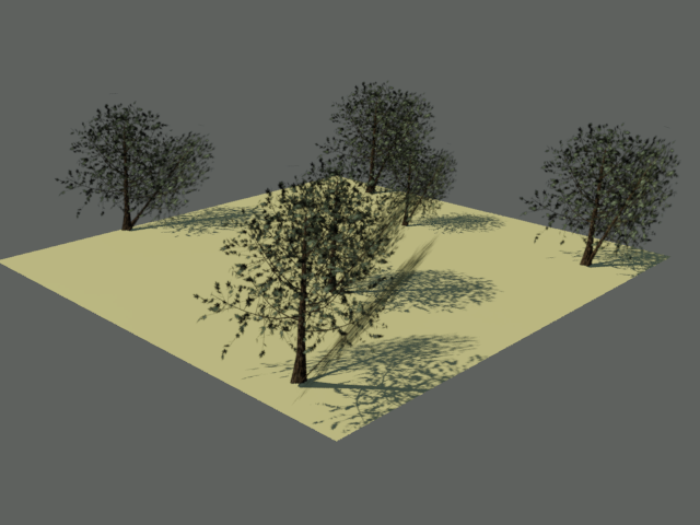

Rendered scene showing two sets of particle tree shadows
There are now two sets of particle trees, each of which cast shadows. You need to hide the shadows of the particle trees that face the camera, then hide the particle trees that face the sun but keep their shadows visible.

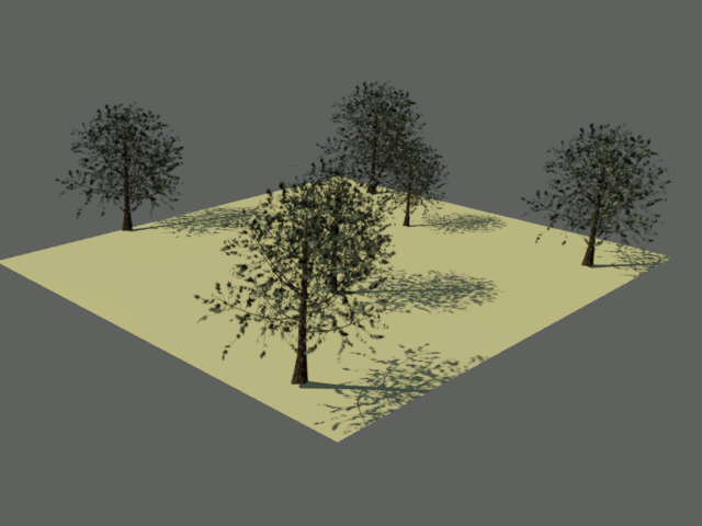

Particle trees with only one set of shadows visible
The rendering shows one visible set of particle trees, and shadows cast by the second set of trees, which are otherwise hidden.
