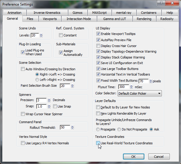

Preferences
General panel
Texture Coordinates group and turn off Use Real-World Texture Coordinates, if it is not already off. Click OK.

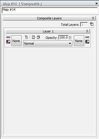

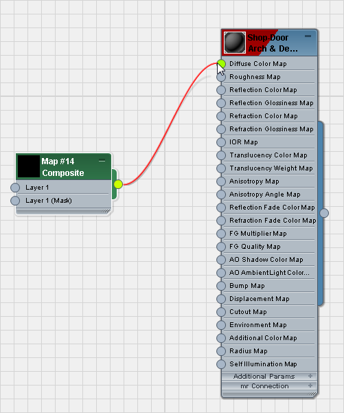

Now you will add a composite map to the material’s diffuse color component.

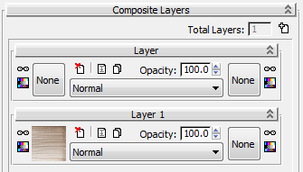

Initially, the Composite map contains a single layer.
Specify the first layer of the Composite map:
3ds Max opens a file dialog.
On the file dialog, choose shutters.jpg, and then click Open.

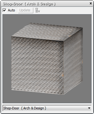

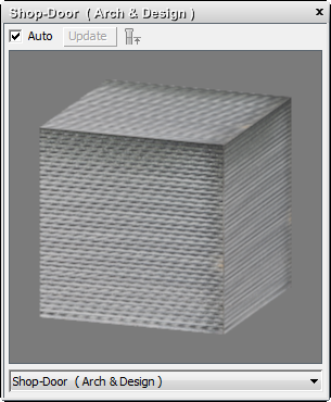

On the Layers 1 rollout for the Composite map, the Texture button now shows the shutters.jpg texture. This texture will be the base layer of the Composite map.

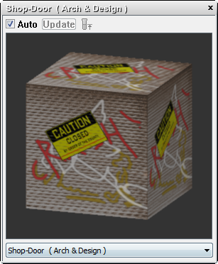

The preview helps you monitor the appearance of the map as you add more layers and make further adjustments.
Box.
3ds Max changes the sample sphere to a cube, which is a better preview of the shutter geometry.

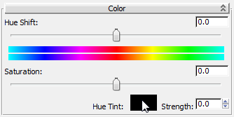

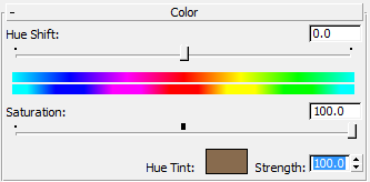

Add a rust tone to the first layer:
The shutter door material is uniformly gray in color. Let’s add a little rust to give the shutter a more run-down appearance.

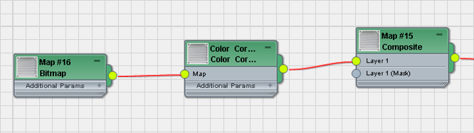

3ds Max displays Color-Correction controls in the Parameter Editor, and it inserts a Color Correction map node between the Bitmap and the Composite map.
3ds Max opens a Color Selector.
Click OK to close the Color Selector.
Now the Shop Door material shows a brownish tint.

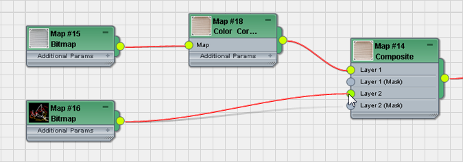

3ds Max adds a new Layer rollout to the display of the Composite map parameters.
Also, in the active View, the Composite map node now shows a new Layer 2 component.

3ds Max adds the Bitmap node to the active View.

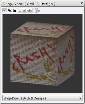

The Layer 2 rollout now shows the graffiti.png texture, and the material preview shows the composited graffiti.
Composite map with the graffiti layer composited on the shutter layer

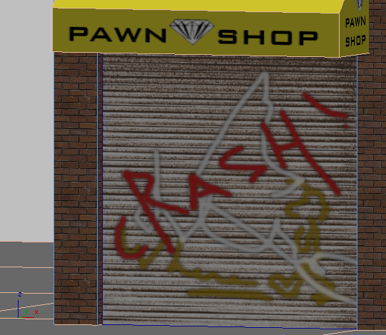

If you look at the Shop Door material in a viewport (you will have to move or minimize the Slate Material Editor), you can see that the default values for compositing graffiti.png make the graffiti appear to float above the corrugated texture of the door.
You will fix this by adjusting some of the alpha settings for this layer.
This slightly increases the overall transparency of Layer 2, so that a small portion of Layer 1 is visible beneath it. The result is a more convincing blending of the graffiti onto the shutter surface.

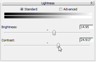

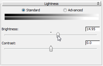

The graffiti layer still needs to stand out a little more: You will use the color correction tools to achieve this effect.

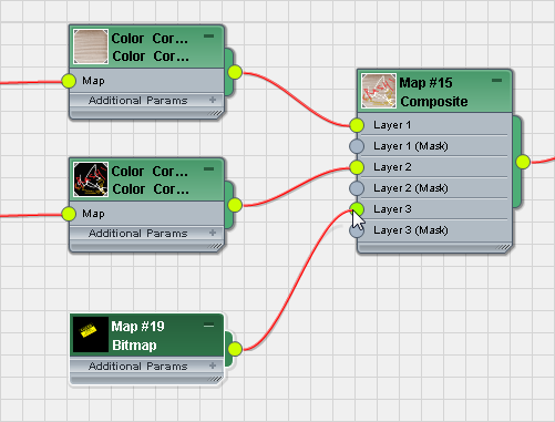

3ds Max inserts a Color Correction node between the graffiti bitmap and the Composite map. This is another way to add a Color Correction map.

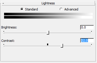

The graffiti colors are now brighter. On the other hand, the change in Brightness affects the semitransparent portion of the alpha channel as well, creating a halo effect around the graffiti strokes, which we don’t want.
Halo surrounding graffiti strokes
You will correct this problem by increasing the contrast level.
Now the graffiti looks more like it is painted on the door.

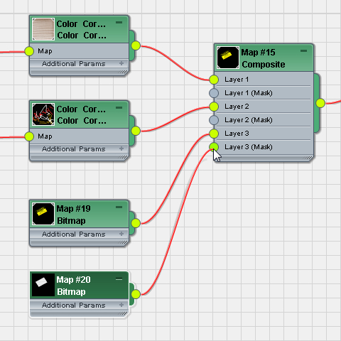

Use a mask to add a sticker:
Now you will add a third layer to your composite map, one that features a sticker.
3ds Max adds a new Layer rollout to the Composite map parameters, and a new Layer 3 component to the Composite map node in the active View.

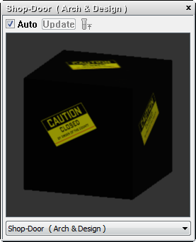

On the file dialog, choose c-sign.jpg, and then click Open.
3ds Max displays the new Bitmap on the Layer 3 rollout and in the preview window.
The c-sign bitmap applied as a top layer in the composite map
Bitmaps saved in .jpg format have no alpha channel information. By applying the c-sign.jpg image directly as a top layer, you have completely obscured all layers beneath it. You can correct this by adding a mask. (You could easily create your mask in a paint program, but a mask image has already been prepared for you.)
On the file dialog, choose c-sign-msk.jpg, and then click Open.
The mask is a black-and-white image that acts as a “custom” alpha channel to the color map.. Black areas of the mask allow the underlying layers to show through, white areas are opaque, and gray areas are partially transparent.
Bitmap used to create a cutout of the poster for layer 3
Now on the Layer 3 rollout, the texture with the sticker appears at the left, and the mask bitmap appears at the right.

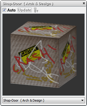

In the preview, the “CAUTION” sticker appears by itself, with the rest of the door now visible.
Layer 3 with the mask applied

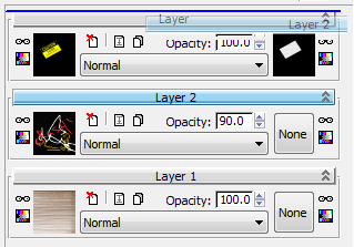

One small problem remains. You want the graffiti to cover the sticker, not the other way around.
3ds Max reorders and renumbers the layers accordingly. (Layer 3 becomes Layer 2, and vice versa.)
Now the graffiti appears on top of the sticker about closure.
