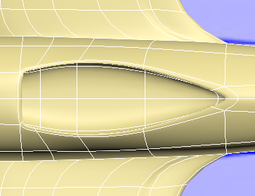

  2. On the ribbon Edit panel, turn on (NURMS), and then on the ribbon Use NURMS panel, increase the number of iterations to the usual value (for the P-47) of 2.

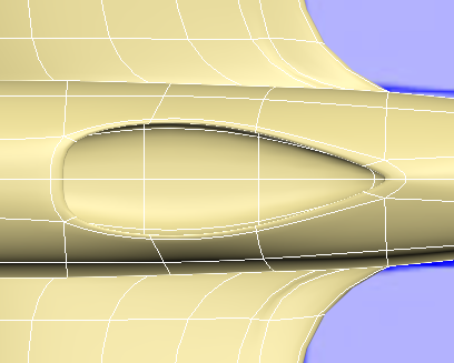

    The model is smoothed nicely, and the cockpit is smoothed all the way around. This is easiest to see in the Top viewport.
    However, the blueprint image shows that the leading edge of the cockpit should be straight. You can fix this by adding some edges (as you saw when you refined the air-intake portion of the engine cowl, placing edges close together reduces the effect of NURMS smoothing).

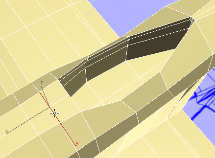

  6. On the ribbon Edit panel, turn on (Swift Loop). Add a new lateral loop of edges, about halfway between the leading edge of the cockpit and the loop of edges that is now in front of it.
    Tip: For this step and the ones that follow, use the Perspective viewport and zoom in before you make the changes.
  7. Right-click to turn off Swift Loop.

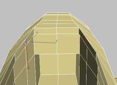

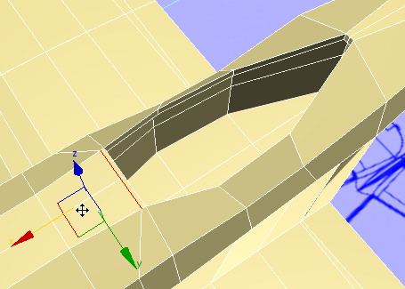

  8. Click and Ctrl+click to select the two edges on top of the fuselage, in the new loop you just created.
  9. On the ribbon Edit panel, activate (Constrain To Edge).

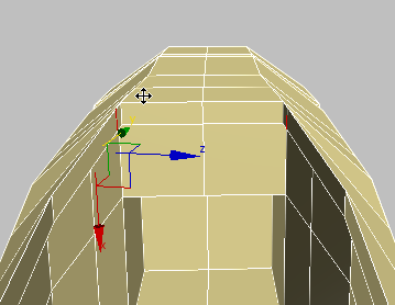

  10. Move the two edges so they are close to the leading edge of the cockpit.

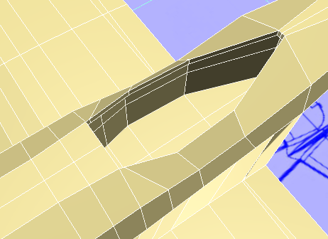

  11. Turn on (Swift Loop) again, and add another lateral loop of edges behind the leading edge of the cockpit, about halfway to the edges that trail it.
  12. Right-click to turn off Swift Loop.

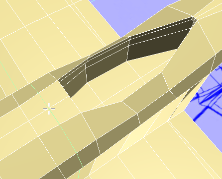

  13. Click and Ctrl+click to select the two small edges along the rim of the cockpit, in the new loop you just created.
    To select both edges, you have to orbit the Perspective view.
  14. Move the two rim edges forward so they too are close to the leading edge of the cockpit.

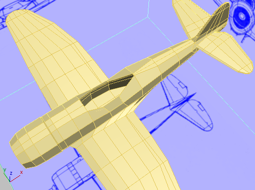

  17. Press Shift+Z several times to undo Perspective view changes, and return to an overhead view of the P-47.

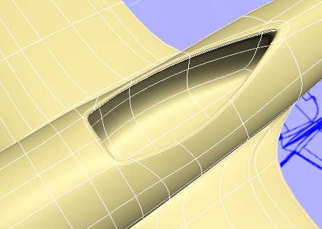

  18. On the ribbon Edit panel, turn on (NURMS).
    The leading edge of the cockpit is now straight, as it is in the blueprint images.
