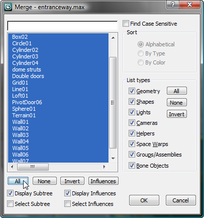

  1. From the Application menu, choose Import Merge, browse to \startup\revolving_door\entranceway.max, and click Open.
    After you click the file name, the Merge File dialog displays a thumbnail of the scene.
  2. In the Merge dialog, click the All button to select all the objects in the scene, and then click OK.
    If the Duplicate Name dialog appears, click Skip for any duplicate objects.
    The revolving door is now in the middle of the entranceway.

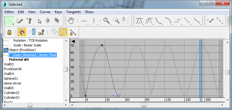

    You can make the doors open and close repeatedly throughout the animation by using Track View.

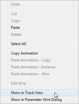

  3. On the Modify panel, find the animated Open parameter, and right-click within the numeric field. From the menu that appears, choose Show In Track View.
    A Track View - Curve Editor window opens with the Double doors Open parameter highlighted.

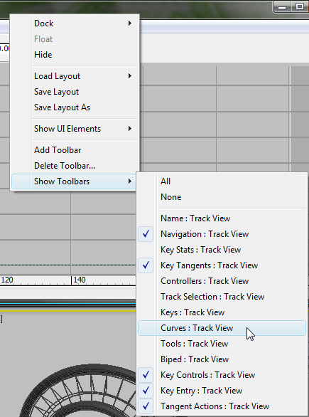

  4. On the Track View toolbar, click (Parameter Curve Out-Of-Range Types).
    If you don't see this button, then right-click a blank area of the Track View toolbar, and from the pop-up menu choose Show Toolbars Curves: Track View.
  5. On the Parameter Curve Out-Of-Range Types dialog, click the Ping Pong graph to make it active (the buttons below it highlight).
  6. Click OK to accept the change and close the dialog.
    The Curve Editor now shows how the animation will repeat.
  7. Close the Curve Editor.
  8. Play the animation again.
    Now the doors open and shut throughout the animation.
