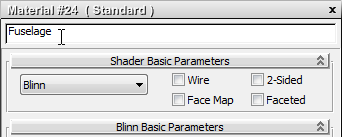

- Double-click the Standard material node so you can see its parameters in the Parameter Editor panel at the right. Name the new material Fuselage.

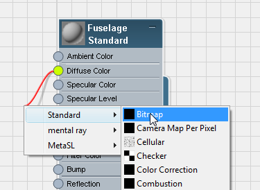

- In the active View, drag a wire from the Diffuse Color input socket of the Fuselage material node, then release the mouse. Choose Standard
Bitmap from the pop-up menu.
3ds Max opens a file dialog.

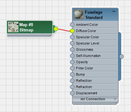

3ds Max adds a bitmap node to the Fuselage material.

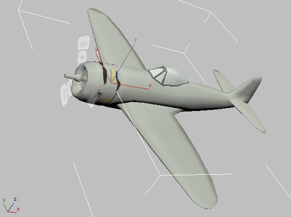

Click the P-47 object, the main part of the airplane, to select it.
- In the Slate Material Editor, click the Fuselage material node to make it active, then on the Slate Material Editor toolbar, click
(Assign Material To Selection).
3ds Max applies the material to the body, wings, and tail of the airplane, but there is no sense to the way the texture is mapped. To arrange the various “pieces” of the texture, you will use Unwrap UVW.
