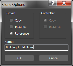

Clone. In the Clone Options dialog
Object group choose Reference. Change the name of the object to Building 1 - Mullions, then click OK.
As a reference, the newly created mullions object behaves in a specific way. Any subsequent edits to the mullions object will not affect the glazing object. However, if you modify the glazing object, the mullions object will be affected. This way, any changes to the modifiers that affect the tower structure, which were created in the glazing object, can be carried forward to the mullions. But any polygon edits intended to affect the mullions only, will not affect geometry in the glazing object.
If the mullions object were cloned as a copy instead of a reference, it would be completely independent of the original.
If the mullions object were cloned as an instance, it would be completely dependent on the original, and vice versa: Any subsequent edits made to either object would affect the other.
