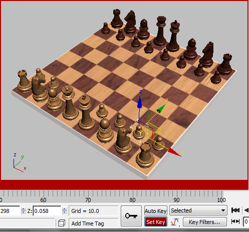

Turn on .
The Set Key Mode toggle turns red, as do the time slider background and the active viewport outline.
In the Perspective viewport, select the pawn in front of the white knight at the lower-right corner. If the transform gizmo isn't already displayed, right-click and choose Move from the quad menu.
Pawn selected and Set Key mode turned on
First, you will set a key to keep the pawn in place at frame 0.
Click (Set Keys).
The button turns red for a moment. A key appears at frame 0 on the track bar.
Note: The Set Keys button also works in Auto Key mode.
Drag the time slider to frame 10.
Using the transform gizmo, move the pawn ahead two squares.
Pawn position at frame 10
Click (Set Keys) to set a key at frame 10.
A key appears on the track bar at frame 10.
