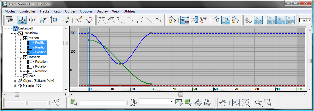

Open the Curve Editor:

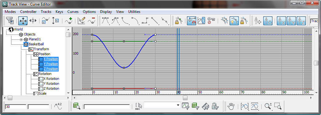

3ds Max opens the Curve editor. The tracks you just created for the ball should be visible on the left, and the curves themselves should appear in the curve window to the right.
The Z track, in blue, clearly shows the up-and-down movement of the ball. The X and Y tracks are both flat, which indicates no change along these axes. In fact, the ball should travel along the Y-axis, as if it were given some forward momentum when it was dropped.

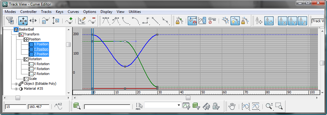

That doesn’t look quite right: As you can see if you scrub the time slider, the ball drops vertically and then travels forward. Instead, the effect we want is a smooth forward motion, as in the diagram at the beginning of this lesson. The culprit is the Y Position key at frame 15, which pins the ball to the same Y position it has at frame 0.
The key turns white when you select it. It also shows some tangent handles.
Now the basketball moves forward from frame 0 to frame 30, as you can see if you scrub the time slider. The animation still looks too mechanical, but you’ll improve that soon.

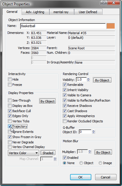

3ds Max opens the Object Properties dialog.
Display Properties group, click Trajectory to turn it on, and then click OK.

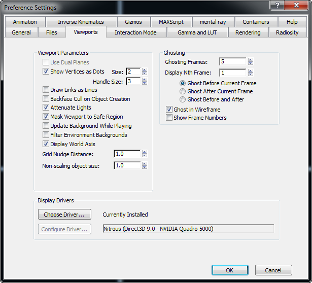

Show Ghosting to turn it on. Now when you drag the time slider, viewports show ghost images of where the ball has traveled.
The default ghosts are closely spaced, and a little hard to read. You can improve this by changing the default settings.
Preferences. Go to the Viewports tab.
Now when you scrub the time slider you see fewer ghosts. The ghosts are spaced two frames apart. This makes it easier to see how the animation is progressing.

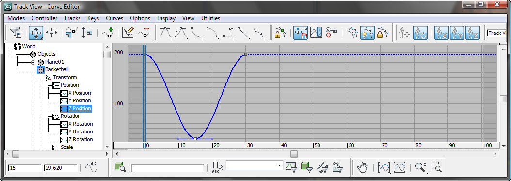

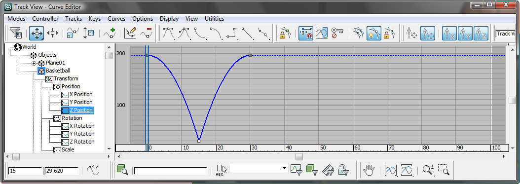

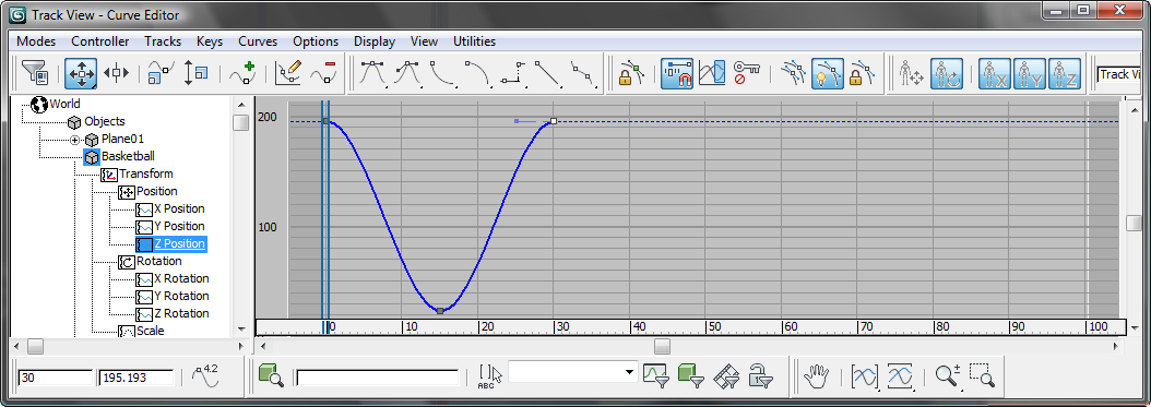

Adjust the timing of the bounce in the Z dimension:
Controller window (the list of objects and tracks at the left), click the Z Position track to display the curve for just that track.
Now the bounce has a snap to it that makes it look more like a real bounce.

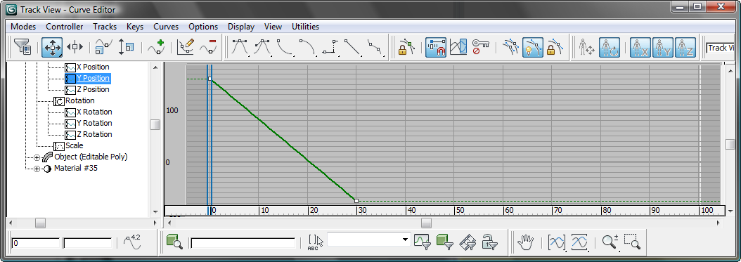

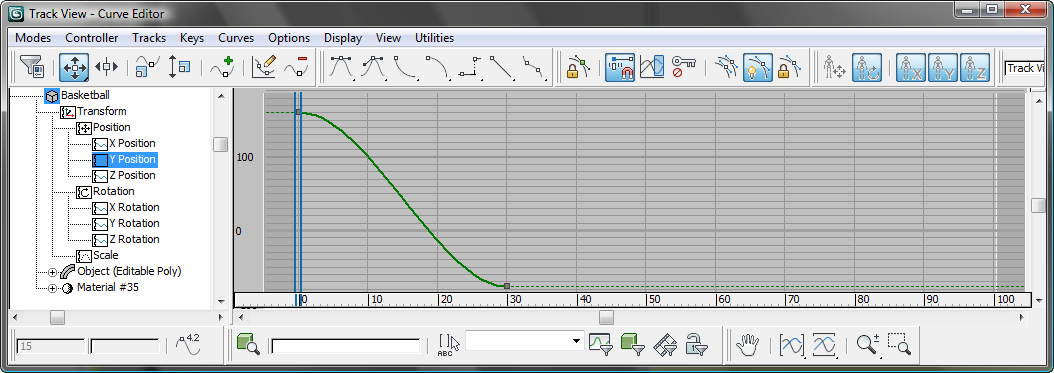

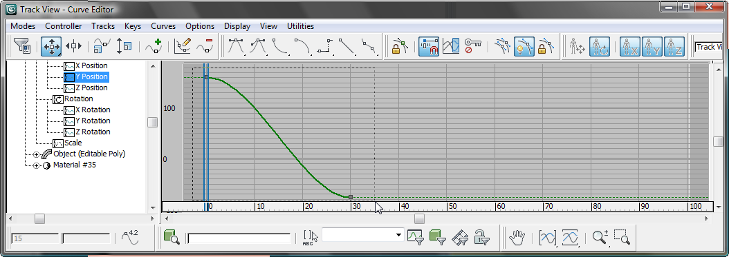

As it did for the ball’s up-and-down motion, Auto Key applied ease in, ease out to the ball’s forward motion. But this isn’t necessary, and in fact would give strange results when you repeat the bounce as you do in the next section.
Controller window, click the Y Position track to display the curve for that track.
3ds Max removes the ease curves from this track, making the forward movement uniform.
