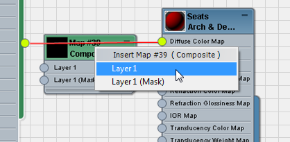

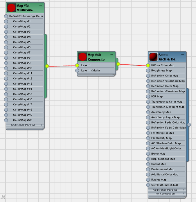

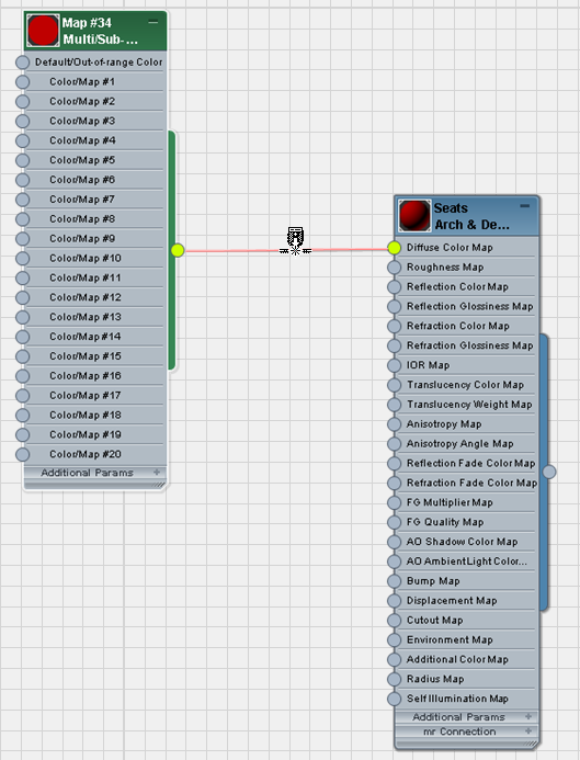

- Drag a Composite map (Maps
Standard
Composite) from the Browser. In the active View, drop the map on the wire that connects the Multi/Sub map and the seats material. 3ds Max displays a cursor that indicates you are inserting the map into the wire. Release the mouse when this cursor appears.
- After you release the mouse, 3ds Max displays a pop-up menu. On the pop-up menu, click Layer 1.
This incorporates the Multi/Sub map as the base layer of the composite.
- On the Slate Material Editor, press L to arrange the layout of the material tree.

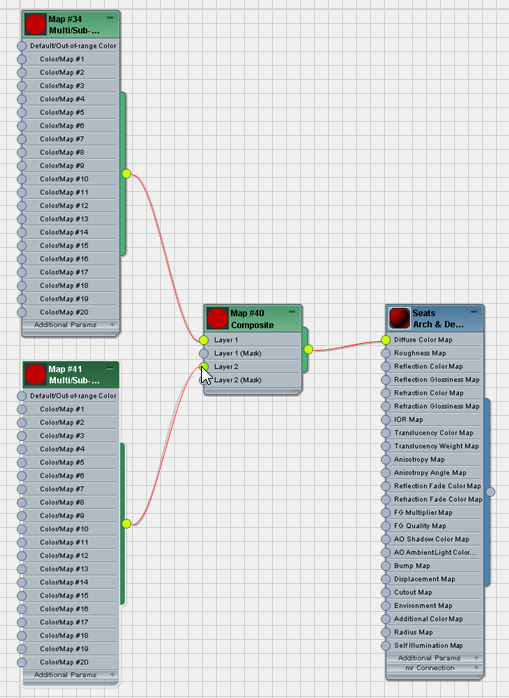

Add a Multi/Sub map to Layer 2:

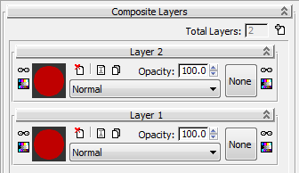

- Double-click the Composite map node to display its parameters.
- On the Composite Layers rollout, click
(Add A New Layer).
- Drag a second Multi/Sub-Map (Maps
mental ray
Multi/Sub-Map) from the Browser into the active View, then wire the new Multi/Sub map to the Layer 2 component of the Composite map.
Tip: Pressing L again can help you see all the nodes. So can the other Slate Material Editor navigation tools. After you’ve used a navigation tool such as Zoom or Pan, right-click an empty area of the active View so you can select material and map nodes once again.

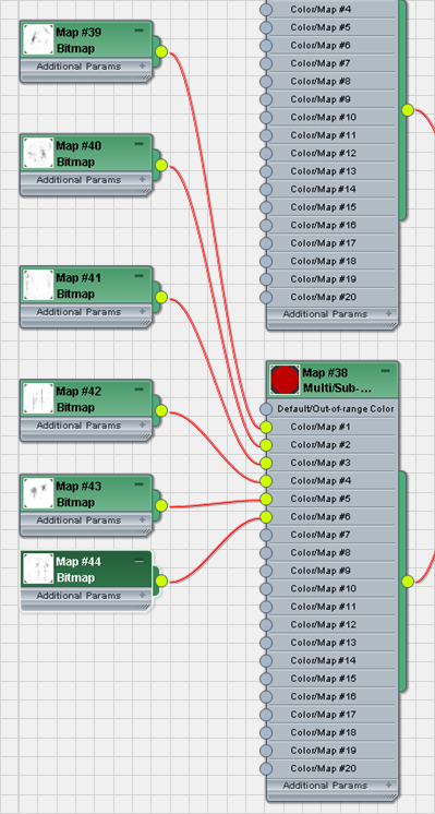

Add the first dirt bitmap to the Multi/Sub map:

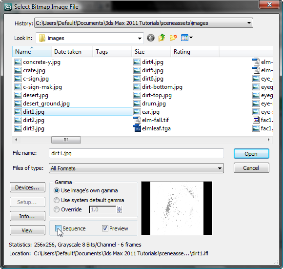

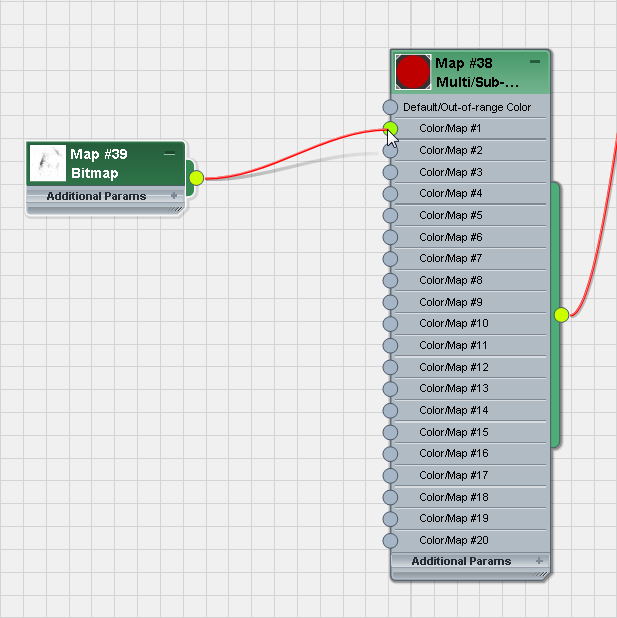

- Drag a Bitmap from the Browser into the active View.
3ds Max opens a file dialog.
- On the Select Bitmap Image File dialog, highlight
and turn off Sequence (otherwise, 3ds Max opens all the dirt files as an animated sequence!). Click Open.
The thumbnail at the bottom right of the dialog gives you an idea of what the dirt1.jpg image looks like.
- Wire the new Bitmap node to the Color/Map #1 component of the new Multi/Sub map.

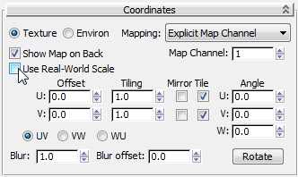

- Double-click the new Bitmap node so you can see its parameters.
- On the Coordinates rollout, make sure Use Real-World Scale is turned off.
Add the other bitmaps to the Multi/Sub map:
- Repeat the previous procedure for the remaining bitmaps,
through
dirt6.jpg.
Wire the Bitmap node for
to the Color/Map #2 component,
to the Color/Map #3 component, and so on.
All six bitmaps wired to the second Multi/Sub map
Define how the two layers composite together:

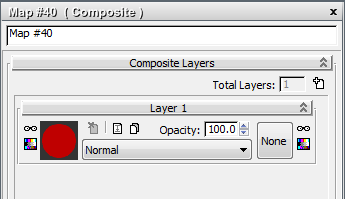

- Double-click the Composite map node to see its parameters.

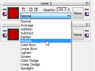

The Operations drop-down list for each layer is set to Normal, which means that the layer with the highest number obscures all layers beneath it. You need to add an operation that will blend the layers together.
- On the Layer 2 rollout, click to open the Operations drop-down list, and choose Multiply.
Now the Composite map combines the color and dirt map layers.

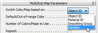

- Double-click the Multi/Sub map node that contains the dirt bitmaps, so you can see its parameters. On the Multi/Sub-Map Parameters rollout, open the Switch Color/Map Based On drop-down list, and choose Random.
- Click Render to render the scene again (still leaving the rendered frame window open).
Now, all six dirt maps appear at random for all seats groups in the stadium. The dirt patterns, however, stand out too clearly.

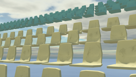

- Click Render to render the scene once more.
The dirt maps appear more faded, giving the seats a subtle variation that appear more realistic.
