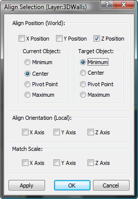

- Make sure the floor is still selected, and then on the main toolbar, click
(Align). Then click one of the walls. 3ds Max opens the Align Selection dialog.
- In the Align Selection dialog, turn off X Position and Y Position. Turn on Z Position. For Current Object choose Center, and for Target Object choose Minimum.
This aligns the floor with the bottom of the walls, along the floor's local Z axis.
- In the Align Selection dialog, click OK.
