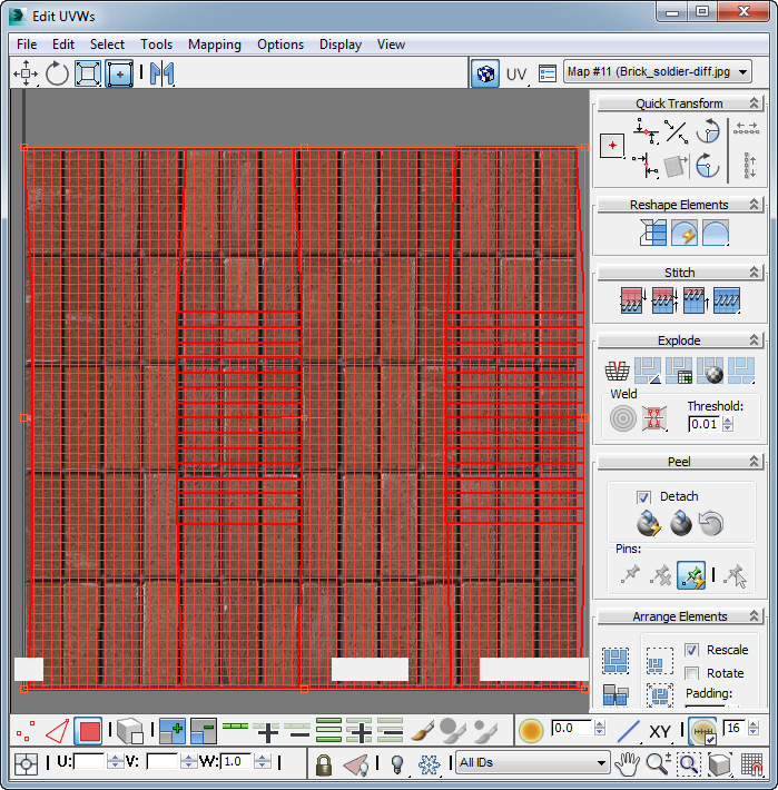

    Arch object displayed as grid of UVW faces and vertices
    The window in the Edit UVWs dialog shows a flattened representation of the arch object. There are four red vertical panels made up of UVW faces and vertices. The panels represent the inner, outer, left, and right face of the arch.

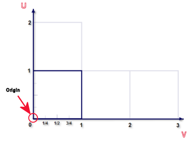

    The square occupied by the flattened arch object corresponds to the dark square in the next diagram, which shows the coordinate system of the Edit UVWs window.
    The texture you apply to the arch object will be mapped to this area, whose coordinate system ranges from 0, 0 to 1, 1.

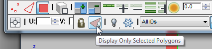

  1. On the second lower toolbar, click (Display Only Selected Polygons) to turn it on.

  3. On the Unwrap UVWs dialog main toolbar, click (Move Selected Subobject), then region-select all the vertices of the left outside edge.
    UVW vertices of left outside edge selected

  5. Region-select all the vertices at the right outside edge of the arch object.
  6. In the U coordinate field, type 1.0, then press Enter.
    This aligns each selected vertex vertically at a horizontal value of 1.
  7. Select in turn, from left to right, the remaining columns of vertices for each inside edge. Give each inner edge a U value of 0.25, 0.5, and 0.75 respectively.

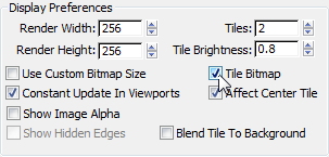

  1. On the Edit UVWs dialog main toolbar, click the options button toward the right of the toolbar.
  2. In the Unwrap Options dialog Display Preferences group, change the value of Tiles to 2, then click to turn on Tile Bitmap.
    Click OK to close the Options dialog.
    Now the brick-soldier-diff.jpg is tiled twice in each direction.
    Note: The Tiling value affects the display of the map in the Edit UVWs window. It does not affect the mapping of the object, which is managed by the Bitmap controls. When Tiling=0, the map appears only in the unit square; when Tiling=1 (the default), the map is tiled 3 times in both U and V; when Tiling=2 (as you just set it), the map is tiled 5 times in both U and V.

  5. On the Edit UVWs dialog main toolbar, activate (Freeform Mode). Make sure all the vertices are still selected, then Shift+drag the top-right corner vertex all the way to the right-most edge of the map.
    Shift+drag the top right corner of the UVW grid to resize it horizontally
    Because the UVW guides have been stretched horizontally to cover three map tiles (from 0 to 3 along the U axis), now three times as many bricks are mapped along the length of the arch.

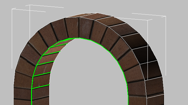

Correct the bulging appearance of bricks at the top of the arch:
    If you look closely at the top of the arch, you can see that the bricks appear to bulge out.
    Bricks in arch show deformation
    This deformation is because the number of divisions in the arch object’s polygon mesh does not match the number of bricks mapped onto them.
  1. On the Edit UVWs dialog, click (Zoom Extents) to zoom in to the UVW guides, then activate (Freeform Mode) again and select only those vertices in the center that correspond to the top of the arch.
    UVW grid with arch vertices selected
    In the polygon mesh, there are 14 divisions that define the arch, but there are 16 bricks in the underlying map. You need to resize the UVW guides so that the mesh divisions match the number of bricks in the map.
  2. With (Freeform Mode) still active, Shift+drag the top-left corner vertex of the selection to the right by one brick.
  3. Shift+drag the top-right corner vertex of the selection to the left by one brick.
    The number of arch polygons now matches the number of bricks in the map.
    Bricks at the top of the arch no longer appear to bulge.

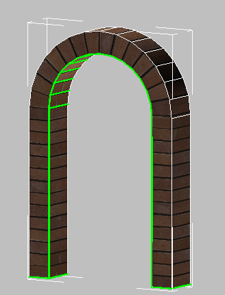

Correct the scaling of bricks in the column:
    If you look at the whole archway, you can see that the fix you just made to the top of the arch, makes the bricks at the top appear larger than the bricks in the two columns.
    Arch bricks are larger than the column bricks.
  1. In the Edit UVWs window, select only the vertices that correspond to the left-hand column of the arch (which is on the right in the Edit UVWs window and the viewport).
    Left column vertices
  2. Shift+drag the top-right corner vertex of the selection to the left by two bricks.
    Left column after being resized two bricks to the left
  3. Repeat the previous two steps for the arch object’s right-hand column, dragging the UVW guides to the right by two bricks.
    All bricks mapped to the arch object, both on the columns and the arch, now appear to be equal in size. The result is a properly mapped archway, with the bitmap convincingly following the contours of the object’s geometry.
    Arch object with bricks of equal size
