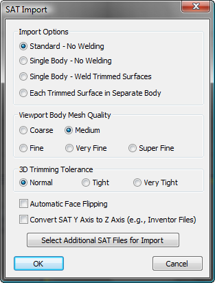

    3ds Max opens the SAT Import dialog.
  5. On the SAT Import dialog, turn on Convert SAT Y Axis to Z Axis.
    In Inventor, the up-axis is Y, rather than Z as it is in 3ds Max. So when you move a file from one product to the other, you have to be careful to make this adjustment.
  6. Click OK.
