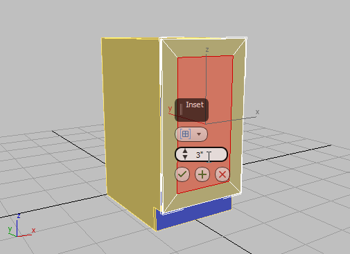

  4. In the viewport, select the front face of the door and on the ribbon Polygons panel, Shift+click (Inset).
    3ds Max displays the caddy controls for the Inset tool.
  5. On the second control of the Inset caddy, Amount, set the value to 3.0, and then click (OK).
    This creates a three-inch inset for the selected polygon.

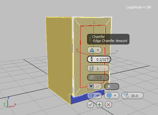

  8. On the ribbon Polygon Modeling panel, activate (Edge).
  9. On the ribbon Modify Selection panel, activate (Loop Mode).
  10. Click one of the edges that surround the inset panel.
    3ds Max selects a loop around the perimeter of the panel inset.
  11. On the ribbon Edges panel, Shift+click (Chamfer).
  12. On the first control of the caddy for the Chamfer tool, Edge Chamfer Amount, change the value to 0 2/32, and then click (OK).
    The inside edge of the raised panel now has a slight bevel to it.

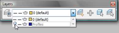

  9. Right-click an empty area of the main toolbar and choose Layers.
  10. On the Layers toolbar, open the Layers list, and click the light-bulb icon for the Profiles layer to unhide the profile splines.
    The three splines appear at floor level, off to the right of the cabinets.
