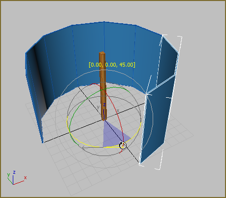

  1. Select the right enclosure panels object.
  2. On the main toolbar, click to activate (Select And Rotate), and then move your mouse over the Transform gizmo tripod in the viewport. When the Z axis (the horizontal blue circle) is highlighted, click and drag to rotate the right enclosure panels object 45 degrees about the Z axis until it touches the left enclosure panels object, as shown below.
    As you rotate, you can see the rotation amount in yellow text in the viewport, just over the transform gizmo. To get the desired result, it should read (0.00, 0.00, 45.00).
    Rotate the right enclosure.
    This rotation is temporary, for the purpose of modeling only.

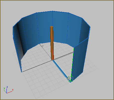

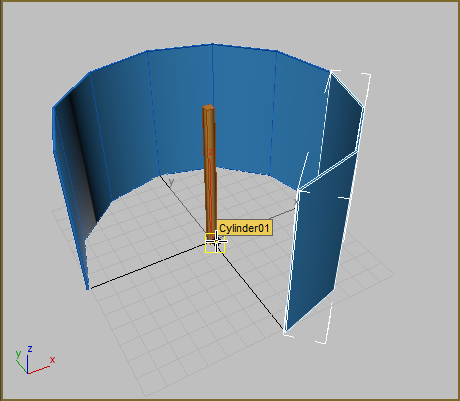

  5. In the Perspective viewport, move your cursor over the cylinder in the center.
    You can see the snap icon that follows the edges of the cylinder as you move.
  6. Position your cursor so you are snapping to the bottom-right edge of the cylinder.
  7. Drag to the right, away from the cylinder, keeping the mouse button depressed. Snap to the front of the right enclosure object. Release the mouse button to set the width of the door.
    Snap to the right enclosure.

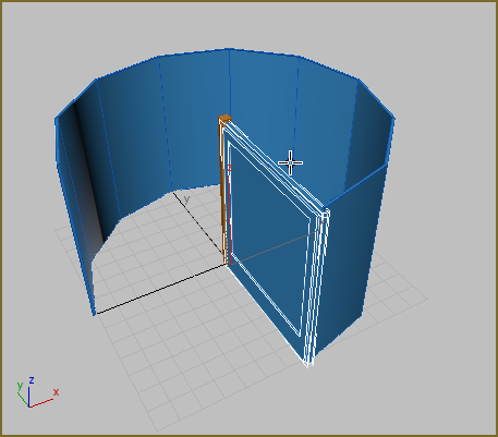

  8. Press S to turn snaps off.
  9. Without moving the mouse, click once to set the depth of the door frame (the default value: 0' 0"), and then move the mouse upward to adjust the height of the door. Click to set the height. Don't be precise about the height: You'll correct this in the next procedure .
    Set the Height last.

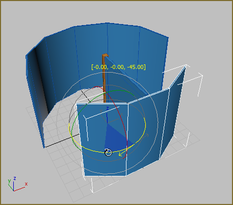

Rotate the enclosure:
  1. Select the right enclosure panels object: the one you rotated earlier in this lesson.
  2. Rotate the sliced tube back into place; that is, –45 degrees on the Z axis.
    Tip: If you prefer, you can enter the rotation in the coordinate display on the status bar.
    Note: If the pivot door sticks through the enclosure after you rotate it, select the pivot door and on the Modify panel, reduce its width so it fits within the space properly.

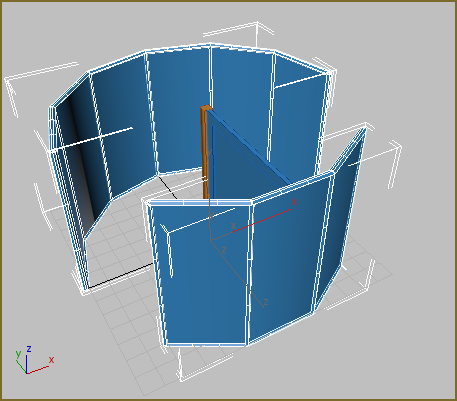

Add struts to the enclosure:
    You'll use a Lattice modifier to add struts to the enclosure. The glass panels will be held up by stout uprights that you will create next.
  1. On the Layers toolbar, choose the Enclosure layer from the drop-down list.
  2. On the Layers toolbar, click (Select Objects In Current Layer).
    This selects both enclosure objects and deselects any other objects.
  3. On the menu bar, choose Edit Clone.
  4. Choose Object group Copy, and click OK.
    3ds Max makes copies of the two enclosure objects and selects the copies.
  5. On the menu bar, choose Modifiers Parametric Deformers Lattice.
    3ds Max applies the Lattice modifier to the enclosures.
  6. In the Parameters rollout Geometry group, choose Struts Only From Edges.
    The right and left enclosure panels now are held up by struts.
