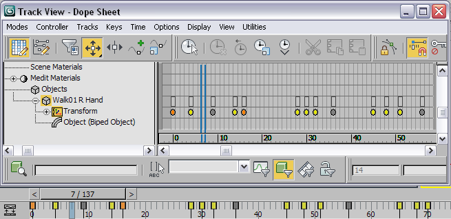

Biped uses color coding for IK keys in three places: Track View, Track Bar, and when trajectories are displayed in the viewports. Also, depending on the types of keys, trajectories themselves can be color coded. The color coding helps you visualize when IK and FK are in use, and the transitions between them.
This topic describes color coding of tracks that are not COM tracks. For information about COM key color coding, see Track Selection Rollout.
Biped IK keys as displayed in Track View and on the track bar use the following color scheme:
All other keys use the default color: gray.
Color-coded biped keys in Track View and on the track bar
