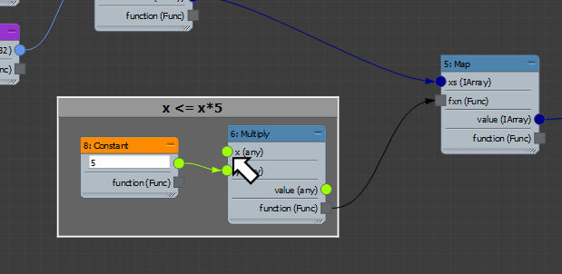

The function output of an input or operator node treats the input node, or the operator node and all the graph to the left of it, as a function. Unconnected input nodes in that graph become the function's arguments.
The unconnected input—x (any)—becomes a function argument.
The order of the function arguments is determined by the order in which the unconnected connectors appear when traversing the graph using a depth-first traversal. In a depth-first traversal the child nodes are visited recursively in top-down order before the node itself is visited.
