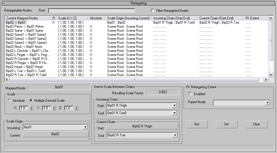

To retarget one character onto another:
This procedure is not a detailed procedure, but an overall workflow. It assumes you have already saved the incoming character's animation, then loaded it onto the current character, as described in To use the Save Animation and Load Animation commands.
For example, if you are retargeting a Biped onto another, you would map the incoming Biped object's position and rotation tracks onto the current Biped.
There is one exception here: if a hand (for example) is going to use IK in the current scene, either don't map it at all, so you can animate it later, or if you are mapping from an FK model to an IK model, map the Exposed World Transform to transfer the incoming FK trajectories to current IK controls.
If the characters are symmetrical and have the same proportions, you can now choose all the mapped tracks in the Retargetable Nodes list. If the characters are not symmetrical, or their proportions are different, then you need to take further steps.
Read the Scale Factor that is set on the basis of the two chains.
If the two current legs are not the same length, repeat step 5 for the other leg, then choose that leg's Foot (or Toe) node, turn on Enabled in the FK Retargeting Extent group, and choose the top of the leg (for example, Thigh) as the parent to use. Click Set.
The fields in this list are as follows:
Typically, you set these two to be the incoming root node and current root node, whose motion tracks are already mapped.
When retargeting character animation, typically you choose the top of the incoming character's leg; for example, the thigh.
When retargeting character animation, typically you choose the end of the incoming character's leg; for example, the toe.
When retargeting character animation, typically you choose the top of the current character's leg (using the same side as you used for the incoming chain).
When retargeting character animation, typically you choose the end of the current character's leg.
If a character's legs are symmetrical, which is usually the case, you only need to calculate the retargeting scale for one leg, and then Set that value to both. If the character's legs are not symmetrical, you need to calculate values for both legs, and also use the FK Extents controls (described below).
When the current model uses IK, 3ds Max knows the extent to retarget because it is defined by the IK solution. But if the current model uses FK, you should specify the extent of retargeting. For example, mapping rotation animation from a long leg to a short leg with different link lengths requires that the short leg’s foot be chosen to retarget so it ends up meeting the floor in the same way the long leg does. In order for 3ds Max to know how far up the chain from the foot to do the retargeting, the parent of the desired chain (for example, the thigh) must be specified. By defining the two chains to compare, 3ds Max can adjust the resulting rotations such that the feet don't slide.
When a character's limbs are not symmetrical, you can also use these controls to keep rotations proportional. First, highlight the current child (for example, a foot or toe) in the Retargetable Nodes list. Turn on Enabled, and then use the drop-down list to choose the upper parent (for example, the thigh) of the limb you are retargeting. Finally, click Set.
If multiple mappings are selected, Get fetches the first highlighted mapping in the list.
