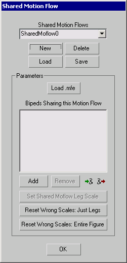

3ds Max opens the Shared Motion Flow dialog.
3ds Max creates a new shared motion flow.

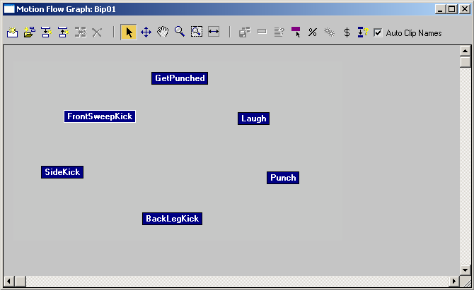

Parameters group, click Add. The bipeds are added to the list. If you add clips to the motion flow graph they will be shared by the bipeds.

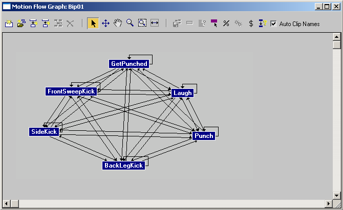

This displays the Motion Flow Graph.
3ds Max opens a file dialog, where you can choose the location of your BIP files.

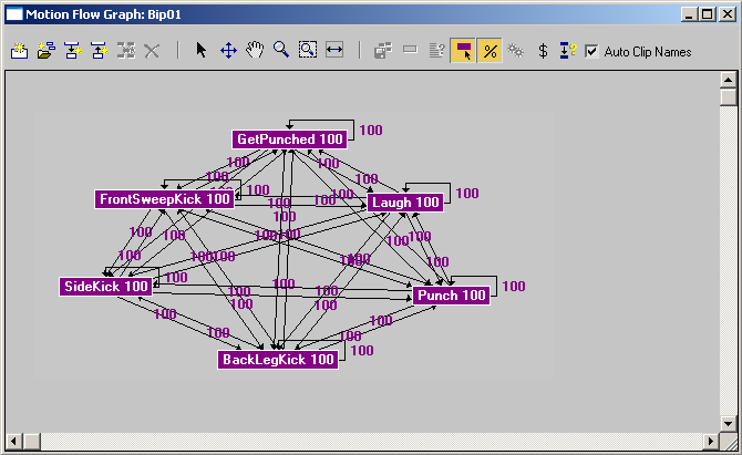

All the transitions linking clips are weighted at 100, meaning all the transitions have a even chance of being chosen randomly.
The clips all turn purple and each is assigned a weighting of 100. Now all the clips have an even chance of starting first.

Make sure the bipeds have the same root names (for example, Bip001, Bip002) as those in the original setup.
The shared motion flow is loaded and applied to the new set of bipeds. The biped names appear in the dialog list. If “(wrong scale)” appears after any biped names, use the Reset Wrong Scales buttons to correct the scales.
