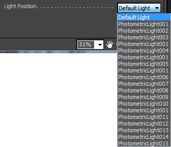

Typically FX shaders are coded to use a specific number of lights: usually just a single light. If the FX file you open is coded this way, the shader-specific rollouts display a control that lets you pick the light to use. For example:
XMSL shaders, on the other hand, are not coded to use specific lights, so they use all active lights in the scene.

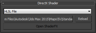

While HLSL File is active, click this button to display a file dialog that lets you open a shader. By default, the FX format (Direct3D Effects) is active and the shader is standardfx11.fx.
While HLSL File is active, click this button to reload the active shader file. To update a shader file, you can edit it and then click Reload. You don't have to restart 3ds Max to see the effect of the changes to the shader.

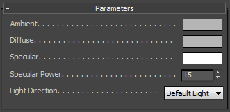

The rollouts that appear below the DirectX Shader rollout and above the Technique rollout are the interface to the shader you chose. These rollouts are specific to each shader.
Parameters for the default10.fx shader

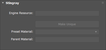

The Stingray rollout is used with Stingray shaders.
