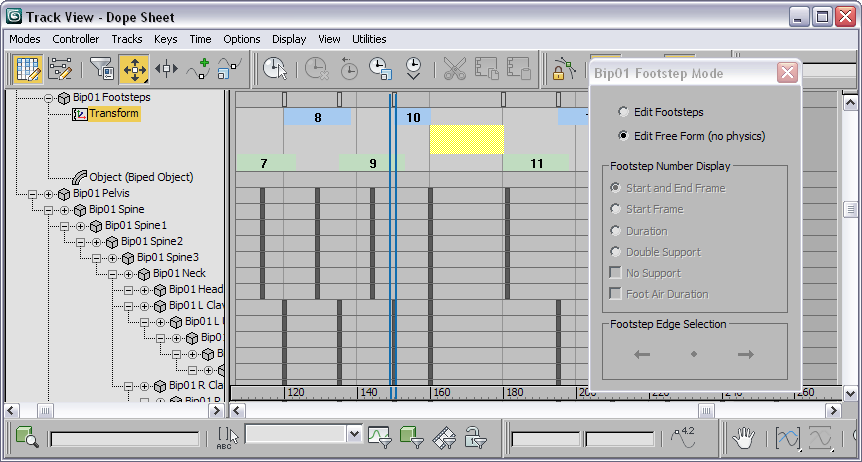

The Track View - Dope Sheet editor is used to insert a freeform period between footsteps. During a freeform period, vertical dynamics (gravitational effects) are suspended, and Body Vertical keys use spline dynamics instead.
To convert an airborne period to freeform mode:
Track View - Dope Sheet from the 3ds Max menu.

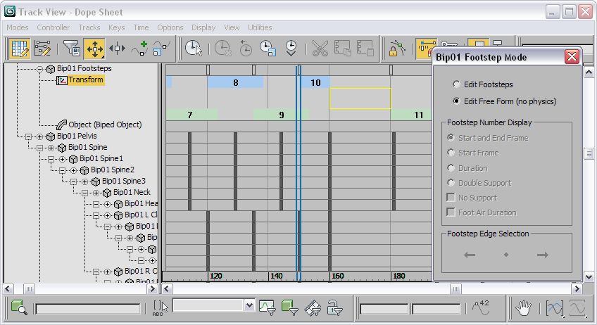

In each airborne period in Track View, a hollow yellow box appears.
No vertical dynamics during freeform period, then return to vertical dynamics during next airborne period.

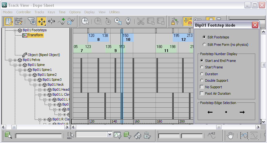

To edit footstep timing after creating a freeform period, you must choose the Edit Footsteps option in the Footstep Mode dialog.
