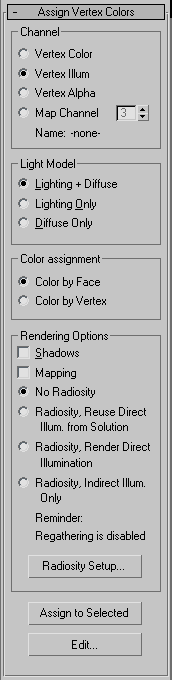

Interface
Channel group
Here you'll find tools to choose which channel type the vertex color utility will assign. If you choose map channel, you can also specify the map channel ID number.
- Vertex Color Choose this to assign a vertex color layer.
- Vertex Illum Choose this to assign a vertex lighting layer.
- Vertex Alpha Choose this to assign a vertex transparency layer.
- Map Channel Choose this to assign a specifically numbered map channel.
- Map channel spinner
Use this to define the channel number. Available only when Map Channel is chosen.
- Name
- If a channel has a name defined, it will appear here. Channels can be named using the Channel Info Utility.
Note: Although the Color, Illum, and Alpha channels have specific names, in fact 3ds Max does not enforce what kind of data is saved in them, and any of the three channels can contain four-channel (RGBA) vertex color data.
Light Model group
Provides options that let you specify how the surface of the object appears to be illuminated.
Color Assignment group
Lets you specify how colors are interpolated across surfaces.
- Color by Face (The default.) Colors are interpolated between the center of each face.
Color By Face samples fewer points, so it is the quicker method. On the other hand, results are less accurate.
- Color by Vertex Colors are interpolated between vertices.
For each face, this method uses three points instead of one, so it is slower but usually more accurate. An exception can occur when an object's shadow falls between two vertices: In such a case, the object should occlude lighting, but because only vertices are taken into account, the shadow is not calculated and a “light leak” occurs.
Rendering Options group
The options in this group let you choose whether to include shadows, texture maps, or a radiosity solution in vertex colors.
Note: You can save a radiosity solution in vertex colors, but not
Light Tracer illumination, which is not stored in the scene's geometry.
- Shadows
- When on, shadows are used when the vertices are shaded. Default=off.
Tip: You can soften the shadow edge by using the VertexPaint modifier's Paint or Blur tools.
- Mapping
- When on, texture maps are used when the vertices are shaded. Default=off.
[radiosity options]
The radio buttons specify how to use radiosity data.
- No Radiosity (The default.) Do not use the radiosity solution when assigning vertex colors.
Note: This option is the only one available unless a
radiosity solution is present in the scene.
- Radiosity, Reuse Direct Illum. from Solution Includes radiosity in the vertex color assignments, and uses the direct illumination from the solution.
This is comparable to the choice Re-Use Direct Illumination From Radiosity Solution on the Rendering Parameters rollout.
This choice disables the Shadows toggle, because shadows don't need to be recomputed.
- Radiosity, Render Direct Illumination Includes radiosity in the vertex color assignments, but uses a separate pass to render direct illumination.
This is comparable to the choice Render Direct Illumination on the Rendering Parameters rollout.
- Radiosity, Indirect Illum. Only Includes only indirect illumination from the radiosity solution in the vertex color assignments.
- Reminder field
- Displays a message that says whether regathering is enabled or disabled. Regathering provides the most accurate radiosity results, but it can add considerable time to radiosity calculations.
- Radiosity Setup
- Click to display the Advanced Lighting panel of the Render Setup dialog, where you can set up and generate a radiosity solution.
If the mental ray renderer is the active renderer, this button is not available.
- Assign to Selected
- Assigns vertex colors to the selected objects based on the assigned material, and the choices specified in the preceding group boxes. Assign to Selected creates a VertexPaint modifier and adds it to the stack of the selected objects.
- Edit
- Switches to the assigned VertexPaint modifier and opens its interface on the Modify panel, as well as the VertexPaint Paintbox, the floating dialog that holds the vertex painting tools.
This button is unavailable if you haven't yet clicked Assign To Selected.
